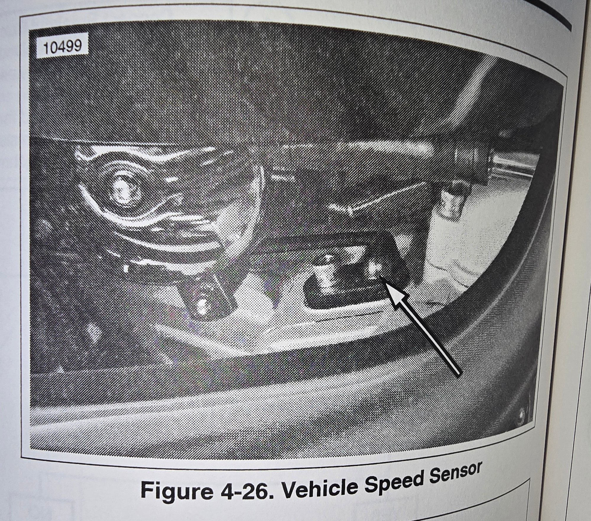

Clean off the pickup on top of transmission.

Do u mean the vvs or vss sensor?

Don't recognize VVS. VSS. There is also a netural switch on transmission
Think the VSS is fwd on left.
Just a guess. If its bad, should throw a code I would think.
P0501 or P0502
