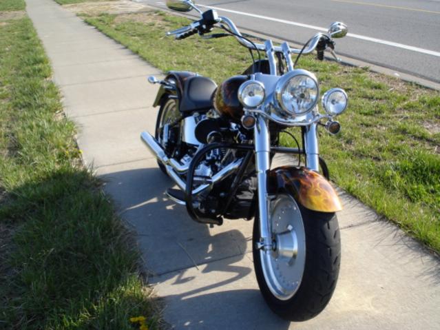

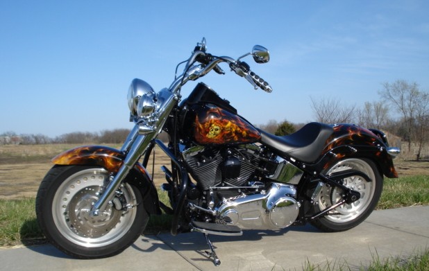

Don't know if anyone reads this thread anymore. Here goes anyway.
I had 6.5" risiers put on mine and it is way comfortable. Probably due to that I am 5'10". Here are some pics.
Danny D
Attached Thumbnails  Pull Back Risers on Fatboy-dsc00543.jpg    Pull Back Risers on Fatboy-dsc00547.jpg    Pull Back Risers on Fatboy-dsc00557.jpg
