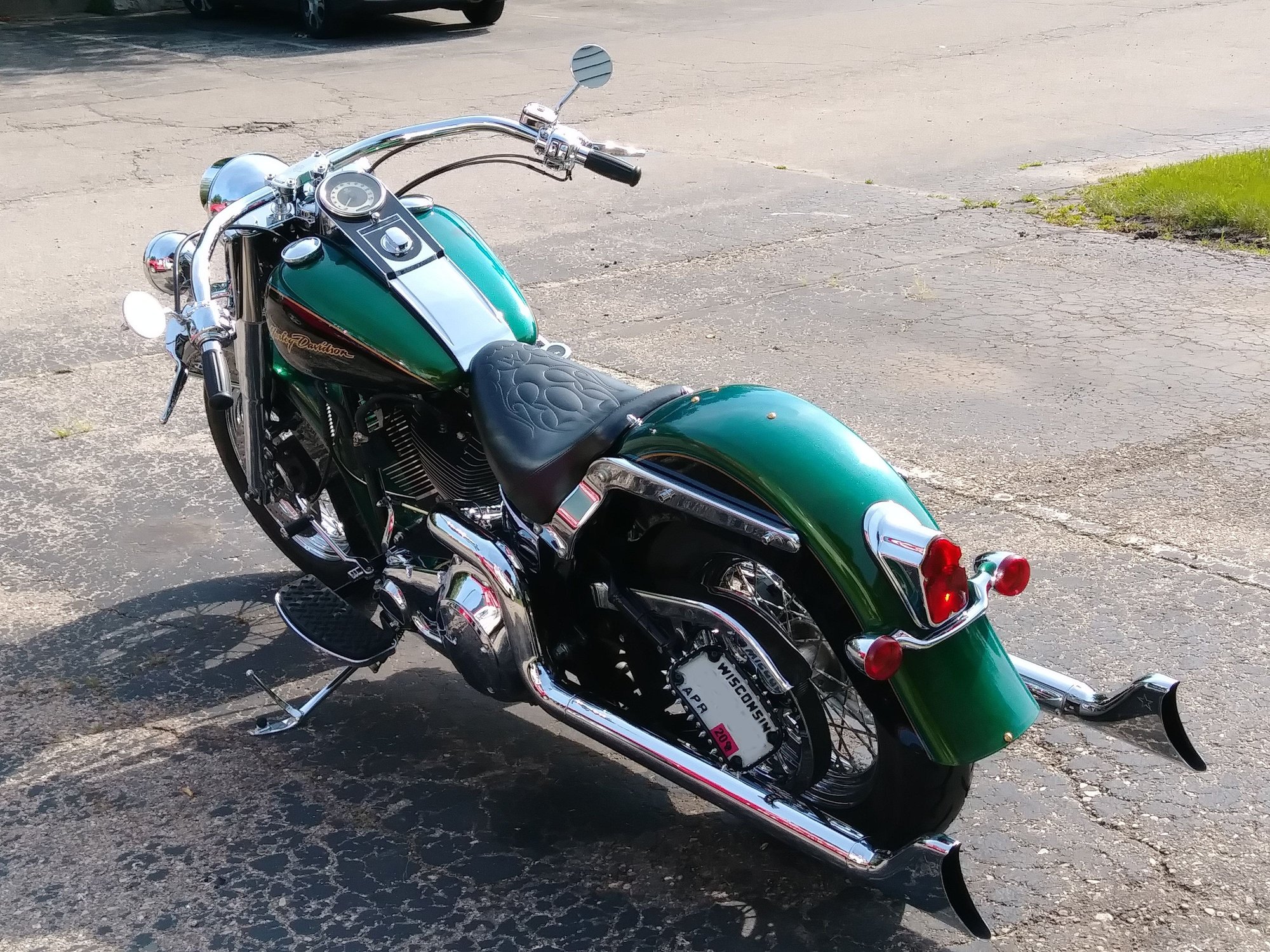

Yes remove your tank if you need to extend wires. Always solder your connections and use shrink wrap. I replaced the bars myself on my Deluxe 3 times before I got the perfect fit. I use a 4' piece of small chain to pull my wires it makes it easy. I loved my Beach Bars, but I like them low and it makes for a very difficult slow speed turn. I use Russell Speed Bleeders for my brakes. http://ps.russellperformance.com/pow...peed-bleeders/

I love the color of your bike Mr. MB! Damn nice!
