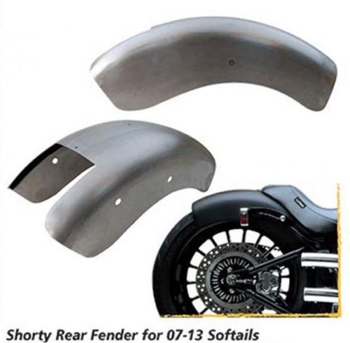

Looks great! I did a similar setup with mine. Your fender looks very close to the tire. That's the look I''m going for but am having trouble with the tire scraping when I go over bumps. How did you get the fender that low and not scrape the tire? Thanks.

mounts to the swing arm... so it moves with the tire!!
how and where is yours mounted??

I did the Shadetree fender too. Very easy to bolt on. And yup...bolts to the swing arm. Bought a 2nd rear wiring harness too. So with 4 bolts and 1 plug I can go back to stock to ride 2 up if I want to.

Ended up using the shadetree on another custom bike and going with an RSD with struts on the bones.
