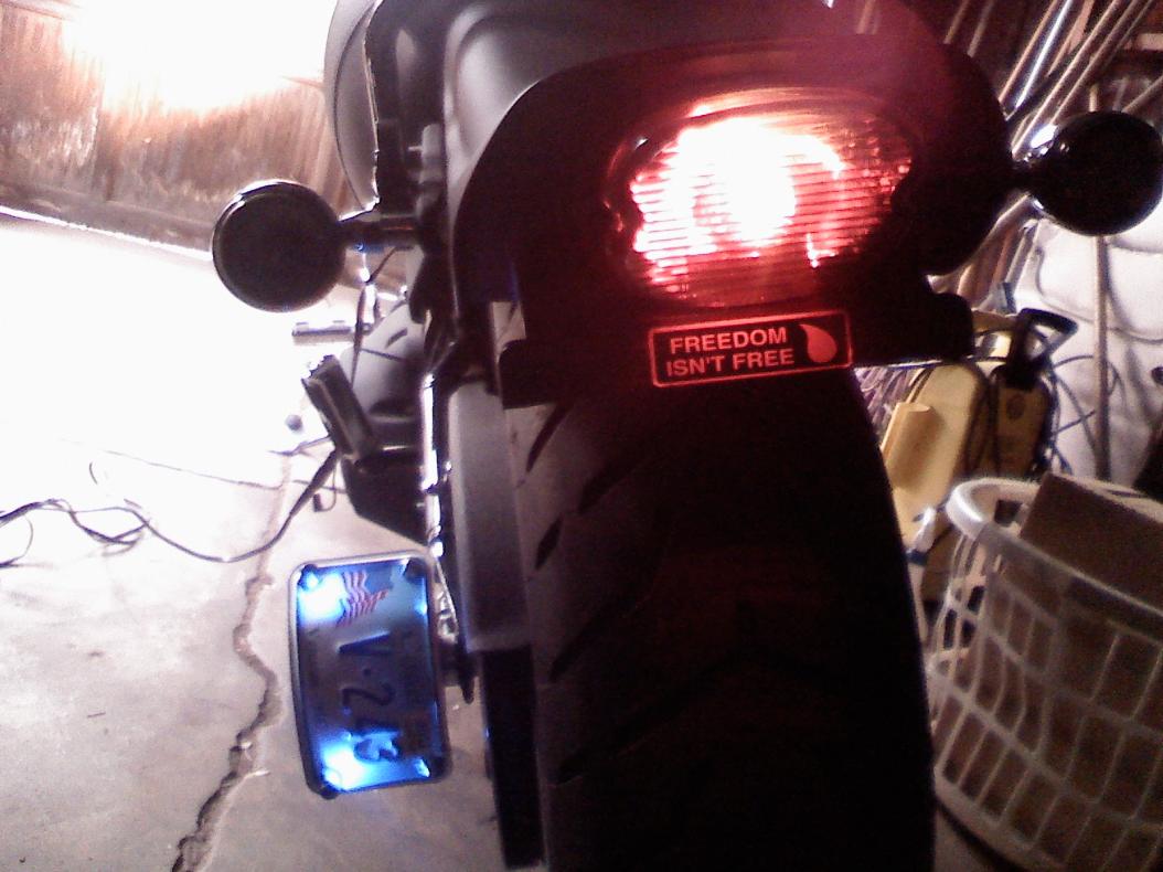

I got a Road 6 Customs side plate.
I then took a Dremel tool, and cut off, and shaved the stock bracket, which I have seen a lot of people do with the Night Train. It took me some time, about 2.5 hours, but that is because I wanted to take my time and do it right, and not mess up. If you do the same, use some painters tape or something to tape up the fender and tire so the plastic coming off doesn't hit the fender or tire. I used a spare box to catch all the flying melting plastic.
Here are pictures to clarify. One shows (with the lights on) before I finished and how I just chopped off the larger part of the bracket and rode around for the last year before touching it up.
The LED lights on the mine were from Custom Dynamics, I since took them off because I changed my battery out, and never put them back on in the past 2 weeks.
