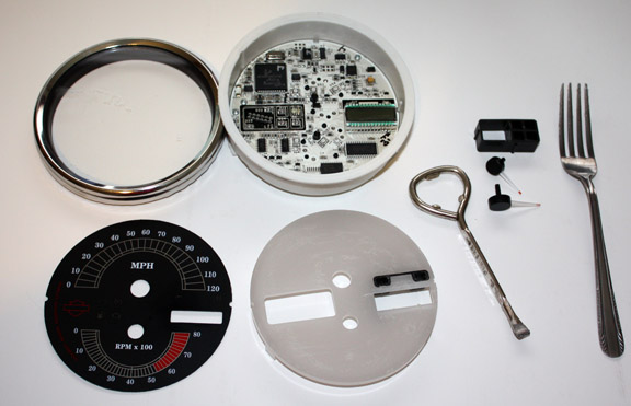

Take a church key and round off the sides of it a little.
Lay the speedo on a soft surface. I used a towel. The church key is a natural for this. Take it with the curved back toward the speedometer and hook the lip under the ring.
Lift the church key. Not all at once. Move it a little, lift. Keep going around until you see a gap.
Take a long blade screwdriver and with your hand on top of the screwdriver to hold the shaft wiggle it down between the gasket and ring.
Pull the screwdriver away from the speedo. Slide the screwdriver along and pull back again.
Don't stop until you can lift the speedometer out with out prying it or you will never get it back in.
Once you get it open you will see there is no way water gets in the front. The speedometer has vent holes in the back and around the connector plug. It has to breath. The speedometer has to get hot to dry it out. Two many high humidity rides with out some heat causes the drip marks.
The fork was to lift the needles off If you want to go farther.
When you put it back together you want to lube the gasket with a little silicone spray. Not much just a little, and work it back together.
I used an old mouse pad. Lay the speedometer down and place your hand on top and press down. Start to form the back of the ring down. Keep pressure on the back of the speedometer. It doesn't take much.
DO NOT SCRAPE THE FACE. It will scratch real easy. You can get replacement glass kit for 5" speedometers but I have not found a source for the 4" yet.
I have done several. It takes patience.

Took mine apart today. Came apart pretty nice but after trying to clean the water spots off the glass I came to find out they somehow etched themselves into the glass so what a waste of time taking it apart. Now after putting it back together I see someone posted that you can get replacement pieces of glass. Please post on where to get the glass.
