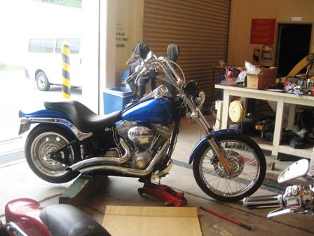

if you can take some weight of the rear tire that will help alot.....if you have a standerd floor jack use a 2x6 and run across and use that...dont need to get it off the ground but get the weight off the rear...

just push your front tire up on a 2x4 or 2x6 and slide under the front frame rail....take the cup off the jack too it makes it lower and flatter surface

For the lift just make a little ramp in front of your front wheel, ride up and let some one push the lift under the bike. Thats the way I do it. Works perfect.

Try this.
Ron
