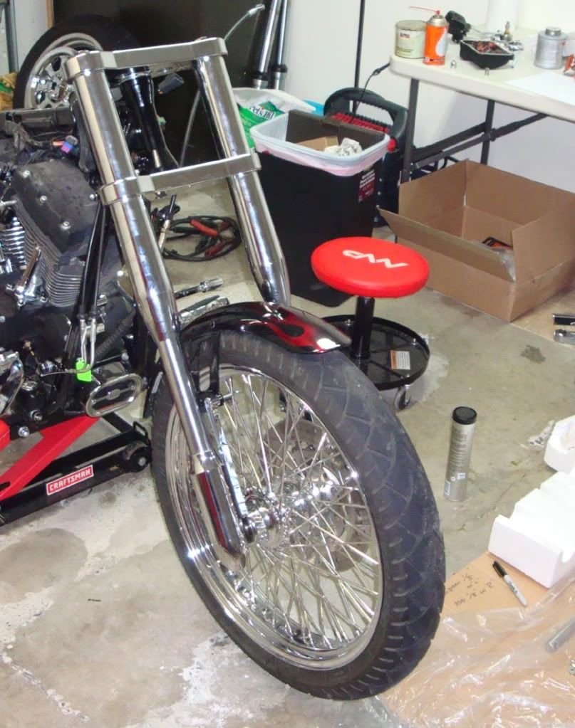

I went through all that last year with my Nightrain and at the time had all the measurments figured out.
Not sure if this will help but here are some pics:
First one is OEM 90/90
Second is the 16" fatboy wheel
Third is 21x3 with the 120 tire.
