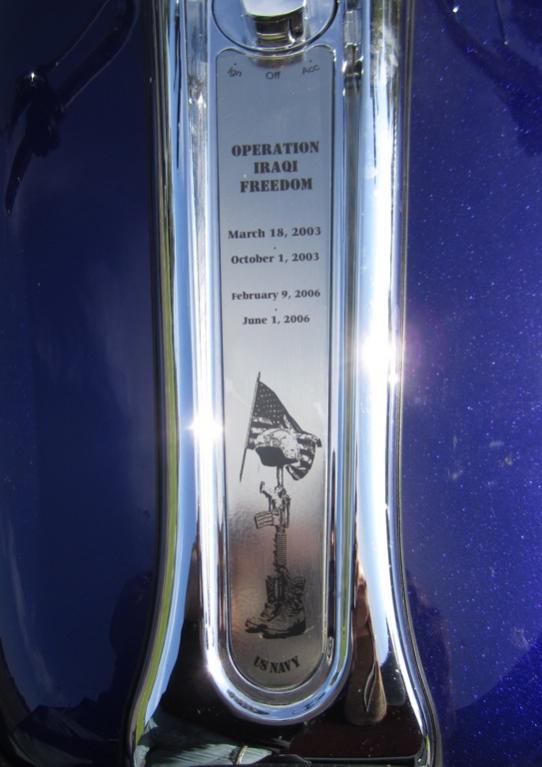

i seen you had posted something bout different console etc on your deuce, but me being a new member i couldnt see the pics. any chance you could post the picture instead of an attachment?

Bob, the pics I posted weren't attachments, they were linked from photobucket. I'll post a pic both ways tho for you.
