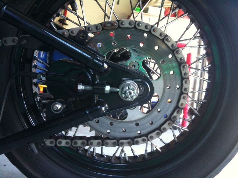

Sunday: I have the Exile Sprotor w/ chain drive on mine. You can buy a front sprocket from any of the catalogs (Drag Specialties, etc...) pretty cheap. From there, it's all getting the correct spacers for proper alignment.

Branner - you have any pics of the exile setup? I'm running a Flyrite Choppers sprotor on my hardtail and like it pretty well, just wanted to see Exiles. How well do you like it?

Sunday: I like it, but would be interested to try the PM set up with the four pistons instead of the two we have. Here's a pic:
