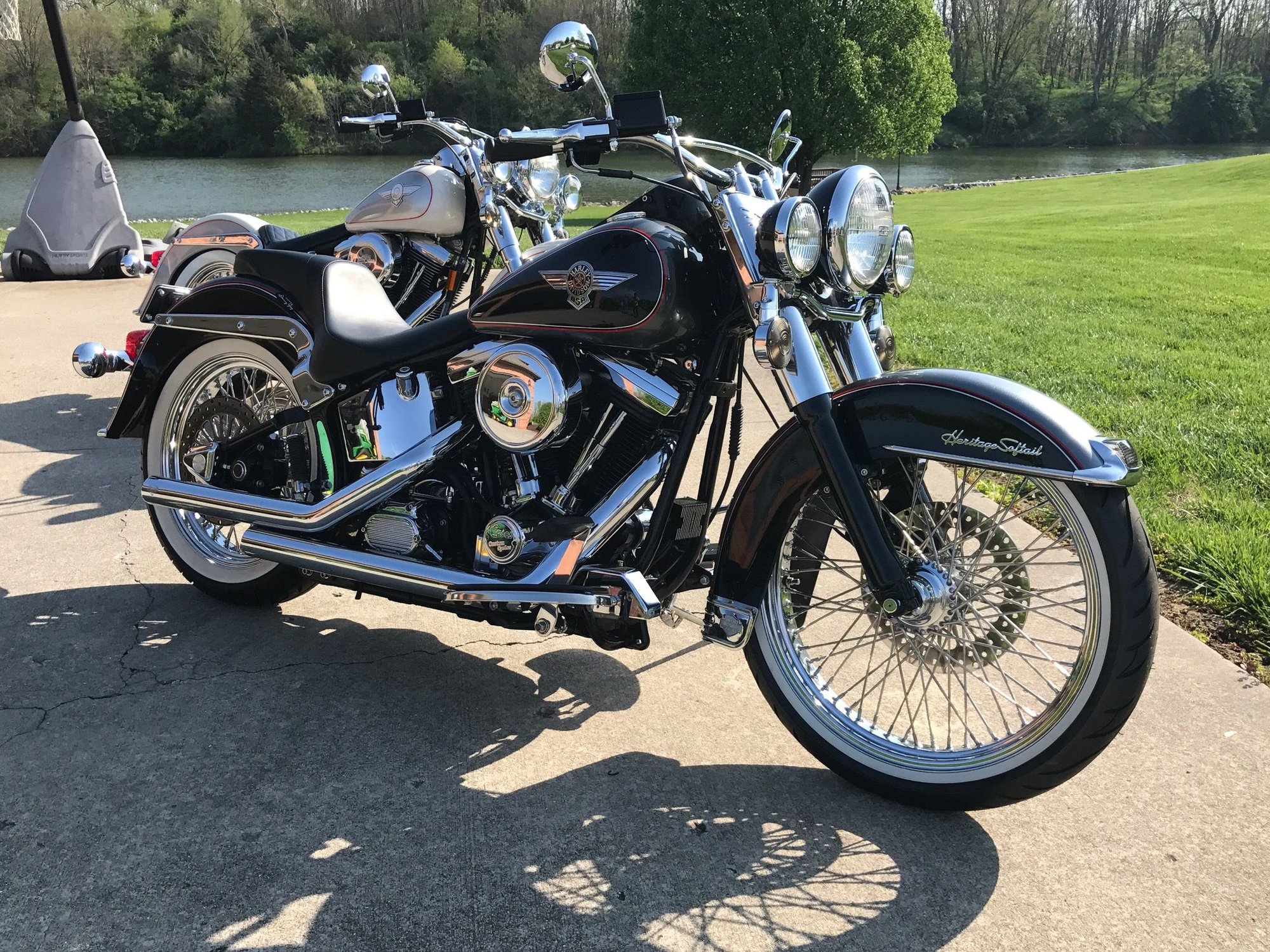

I have a 95 FLSTN with 60 spoke 21" and 18" wheels with billet hubs I bought from KC International that have been just fine so far. I did have to play around with the spacing when I installed them but it wasn't a huge issue. I also have a 94 FLSTN with 60 spoke wheels and billet hubs that I had Black Bike wheels build for me and they are even nicer. I ordered them specifically for my year and model and they bolted right on with zero issues. I highly recommend Black Bike Wheels and they will build you about any style you want, so fat spokes should be no problem for them. I

Nice work BK ... im looking to buy a 21x3.5 / 60 "polished twisted" standard size spoke / black rim / black hub / brass coated **** for a 1999 EVO Softail FLSTC . Front Fender irrelevant,thats easy fix. My problem is finding what I want like bkb5 has. The issue comes to the pre-2000 models have 3/4 timken bearings . 2000-up has 3/4 sealed bearings and I think the od is different .I have found one since all this started,not Exactly what I wanted but could settle for $589+tax +shipping,ill have to check my emails on company that makes it. Ive been reading that its possible to upgrade 99 to 2000 front wheel swap but needs spacing and the rotor is different. can anyone go into detail and share your wisdom on this. Thanks Fellas
