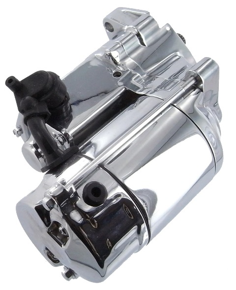

This is the starter I am looking at. Does anyone see a problem?
http://www.ebay.com/itm/Starter-Chro...6ea69e&vxp=mtr
If you have a nice, chromed out ride this is great. But if you think about it, chrome parts need shining and a starter can be difficult to get in there and shine this up, unless it's just a show model or you have a love of chrome.
