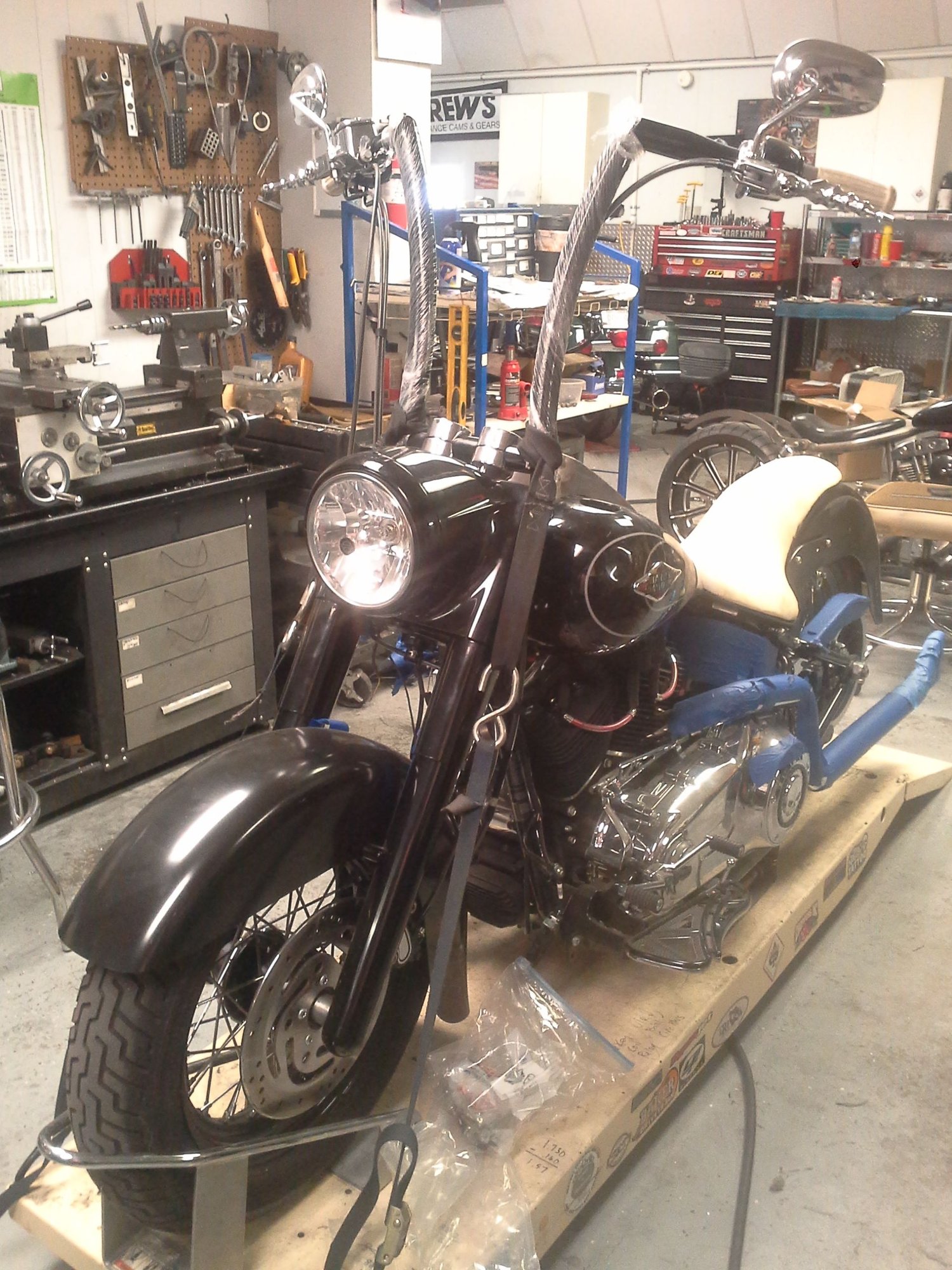

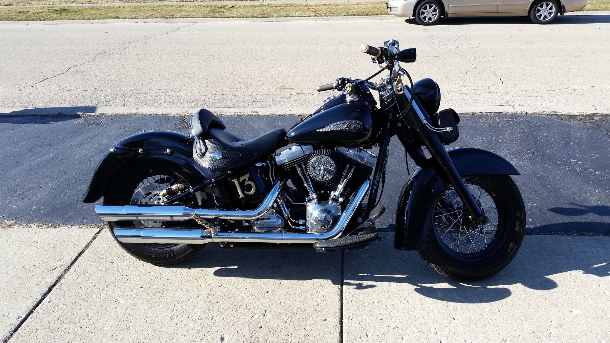

This thread is pretty much my bike. I have always love the Deluxe but right now I'm not a chrome guy.
The slim is a very paticular bike, not many things aft of the engine are shared with other bikes.
The rear fender is approximately 1/4 more narrow than a deluxe, the fender struts are closer together, they are also slimmer below the seat.
This being said, I couldn't by a use deluxe or heritage rear fender without both inner and outer struts. The answer came from JP Cycles were I purchased a 95 heritage 7" wide tailight less fender. None of the existing holes will work including rear pillion.
You will also have to cut out the front to allow for the computer and bend it to replicate o.e. quite easy with a little confidence.
Front and rear fenders and used seat welded prepped and painted $1800
