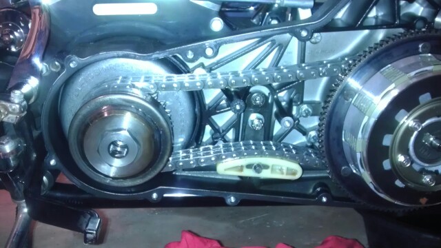

From: Badsville, So. Cal.
Since you have an '06, and you say you can feel it in the floorboards, I think its time you pull the primary cover off and check the compensator nut. I know you said you checked the primary chain tension and all was good, but the nut will have no bearing on that adjustment. It just makes noise/vibration and WILL chew up your splines on the Stator rotor and on the compensator sprocket shaft. Ask me how I know, and why I run a BDL closed belt drive now....

Appears to be tight... I cant move it at all laterally by hand... I assume it would be very loose if it came loose?
