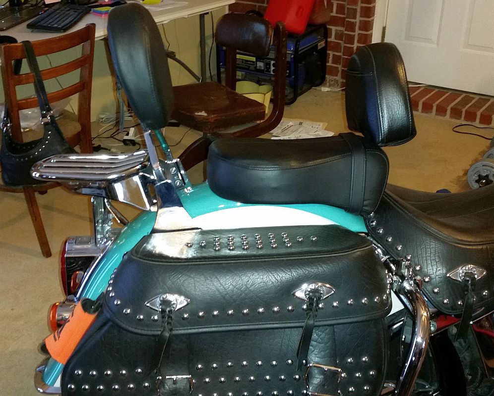

Similar situation here.
Mary lowered her seat, then the backrest was uncomfortable. She took some of the foam out of that. Still not what she wanted.
We ended up moving the backrest back 3" on the fender struts.
Here's a pic- she now has plenty of room, backrest is now comfy for her.

The reason we did what we did was because as much as anything else, she wanted more room between her backrest and mine.
To lower her backrest you could cut off some of the metal posts that mount the backrest to the bracket, then drill a couple of holes, moving the entire backrest and sissy bar down some.
The other option is that you can get different backrests mounts (sissy bar) from HD.
I am looking at a few in the HD Catalog right now-
52754-04 (low)
52737-94A (short)
