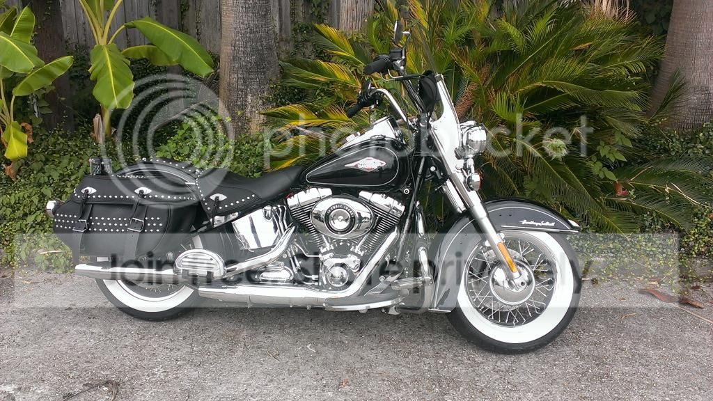

As I stated in another thread, I picked up this 2001 Heritage Classic about a month ago. This is my first HD....I have ridden most of my life, but always metric bike....I always wanted a Harley but couldn't afford it until now.
My question is about the exhaust that's on my bike....from the sig pic you can tell the bike has duals with fish tale slip ons
The fish tales aren't my style and I want to change them out with something more my style and something that will create a better sound and also increase performance.
First question is how can I tell what brand exhaust is on the bike....I have looked for markings on the pipes and the slip ons and can't find anything
2nd, are most slips ons standard sizes at the connection end? I don't want to get something that wont fit my pipes
3rd, what would you guys recommend I get to improve sound and performance?
sorry about all the rookie questions.

No clue on how to tell but you may be able to do an image search for Harley Fishtail or true duals and find a picture that looks exactly like yours and go to the page.

They are likely Samson's.
They do sell a non-fishtail muffler for that set up. Won't do anything, power-wise.
My '04 ran very lean with these, and if I do another FLSTC, I'll probably just get some inexpensive slip-on's and the air cleaner, and use my Power Vision to tune.
True duals rob torque, and only make a bit more power on the high end, they say.

For performance you will need to go 2 - 1 and a less restrictive air cleaner than the stock unit, I could not tell from your picture if that is a stock air cleaner. We have the Bassani Road Rage 2 - 1 on our bike and even with the stock air cleaner the bike picked up some performance, I have now gone the full "Stage 1" (air cleaner and exhaust upgrade) on our '12 FLSTC with the Arlen Ness Inverted air cleaner and installed the "Performance chips" Vigilante EZ tuner to fatten up the air fuel ratio, no more decel popping and the engine is running cooler.
