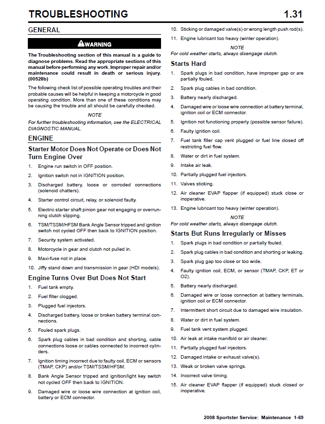

two items here look them over. one is from the ED manual and the other is from the service manual. pick up a service manual when you get a chance, they a 60 new at the dealer and can also be found on secondhand.

Thank you! I'll check these out. I'll let y'all know how it turns out.
