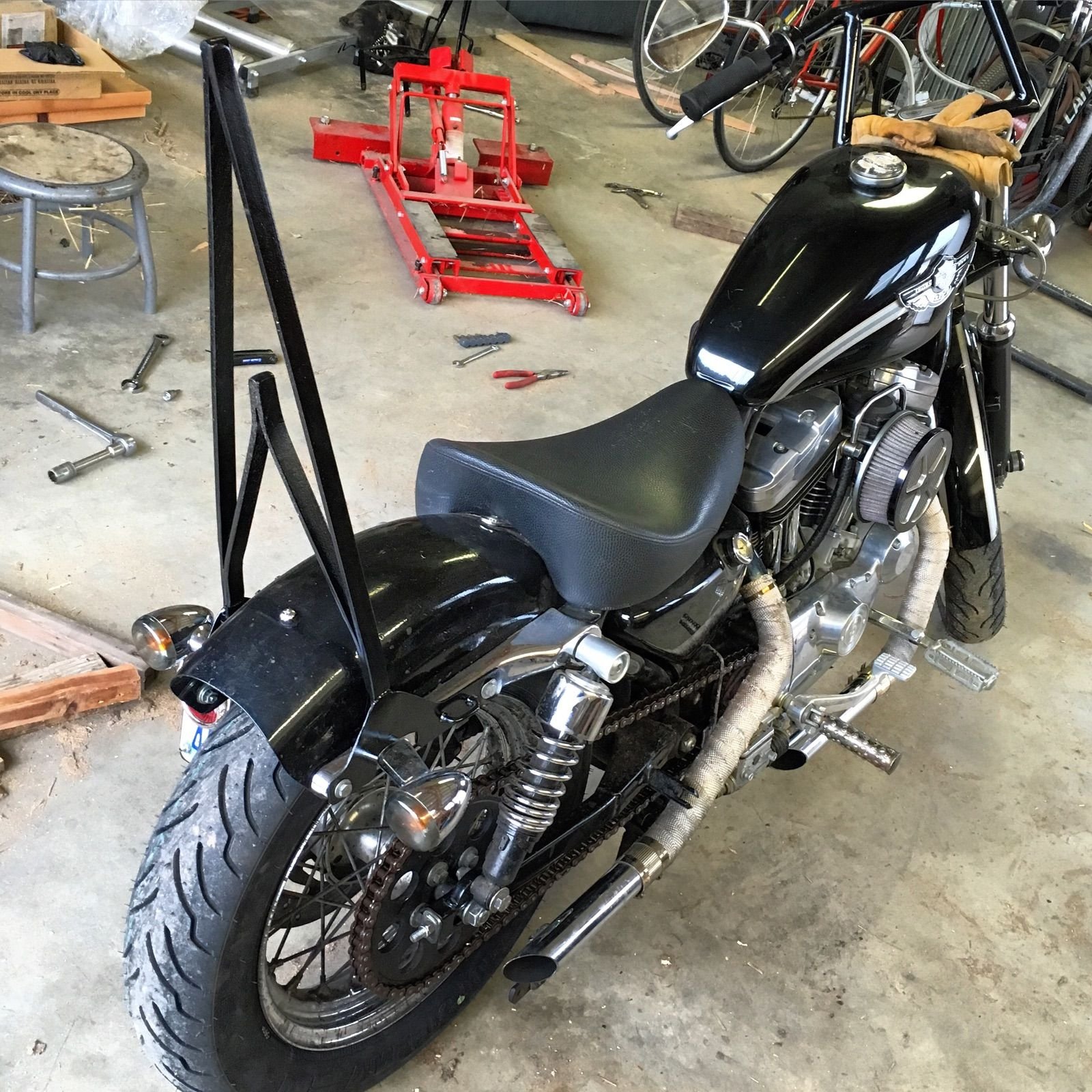

Here are some more photos of what I have made
Here is the eyebrow. I'm still working on it.

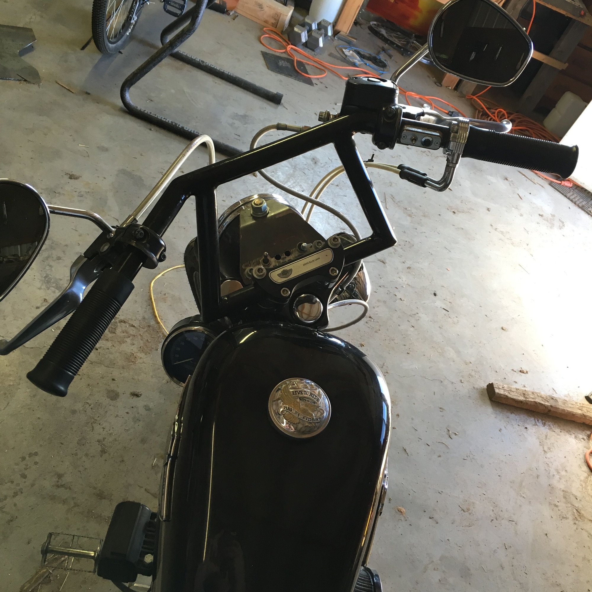

My bars that I made. Window bars with a little bit of Z bar flare

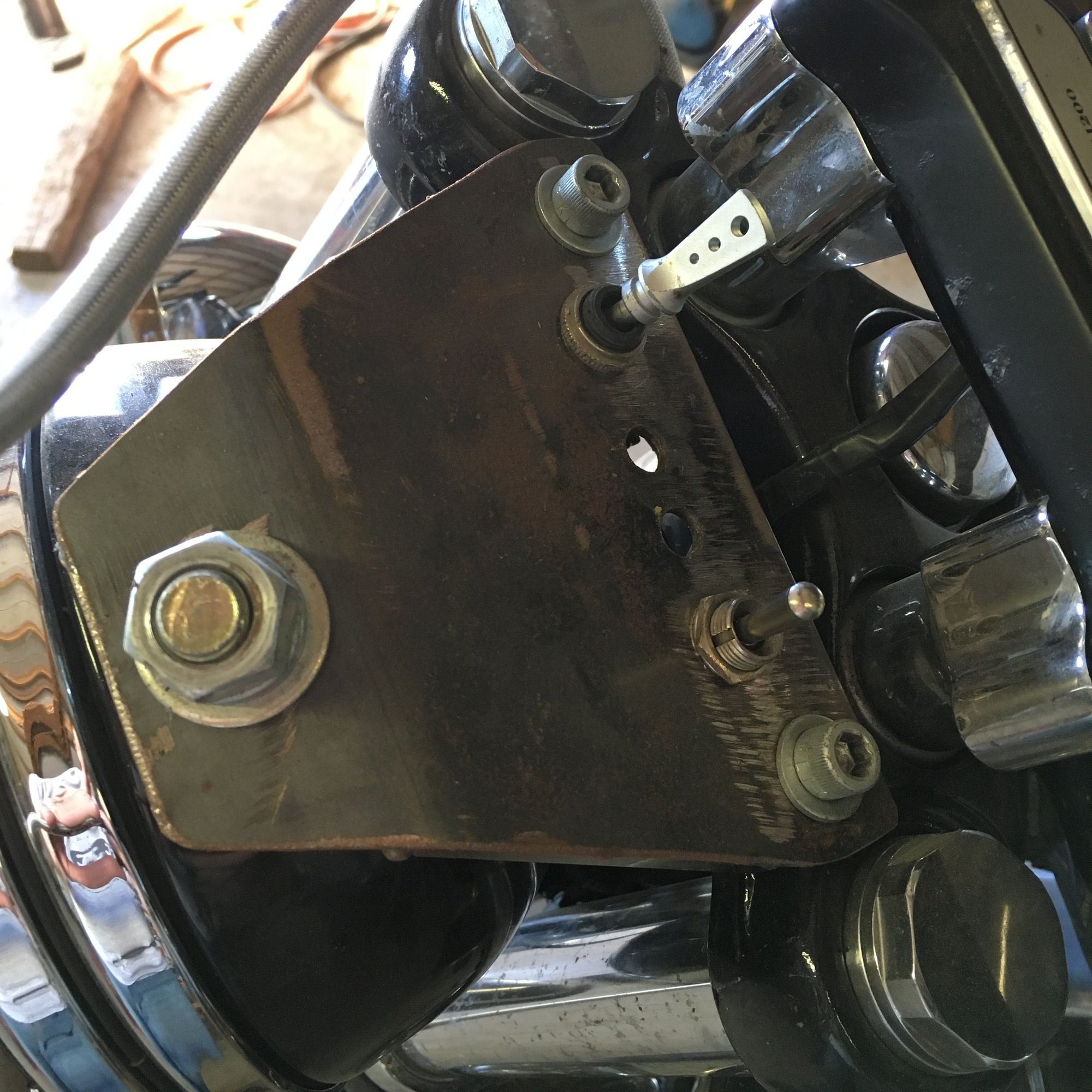

Moved the ignition under the battery box. Made the holder for it.
Here is my stach tube. I keep my insurance and regritration in there

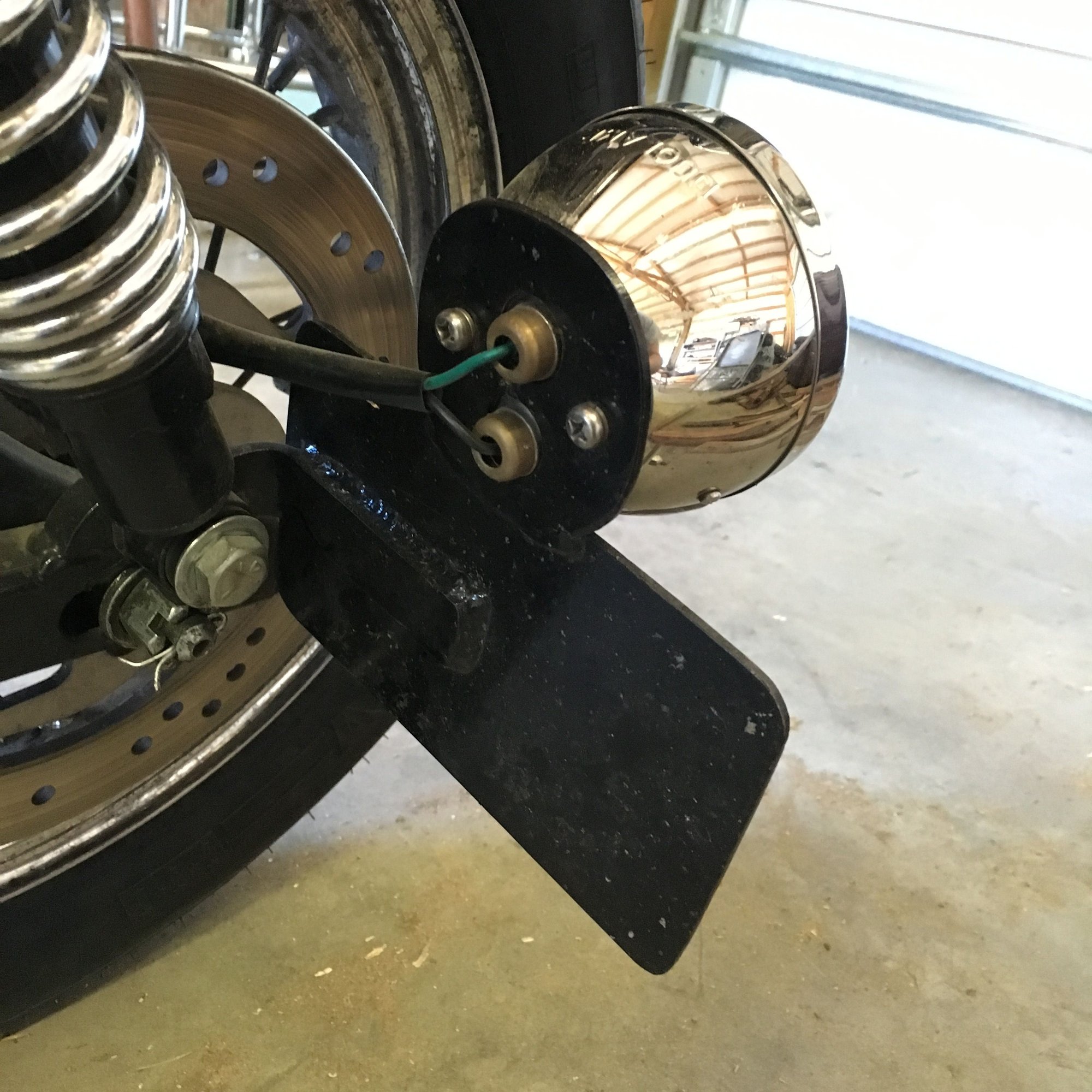

Lience plate holder. It attaches to the shock mount.
My highway pegs and my mids. Thinking of modifying them for something different.

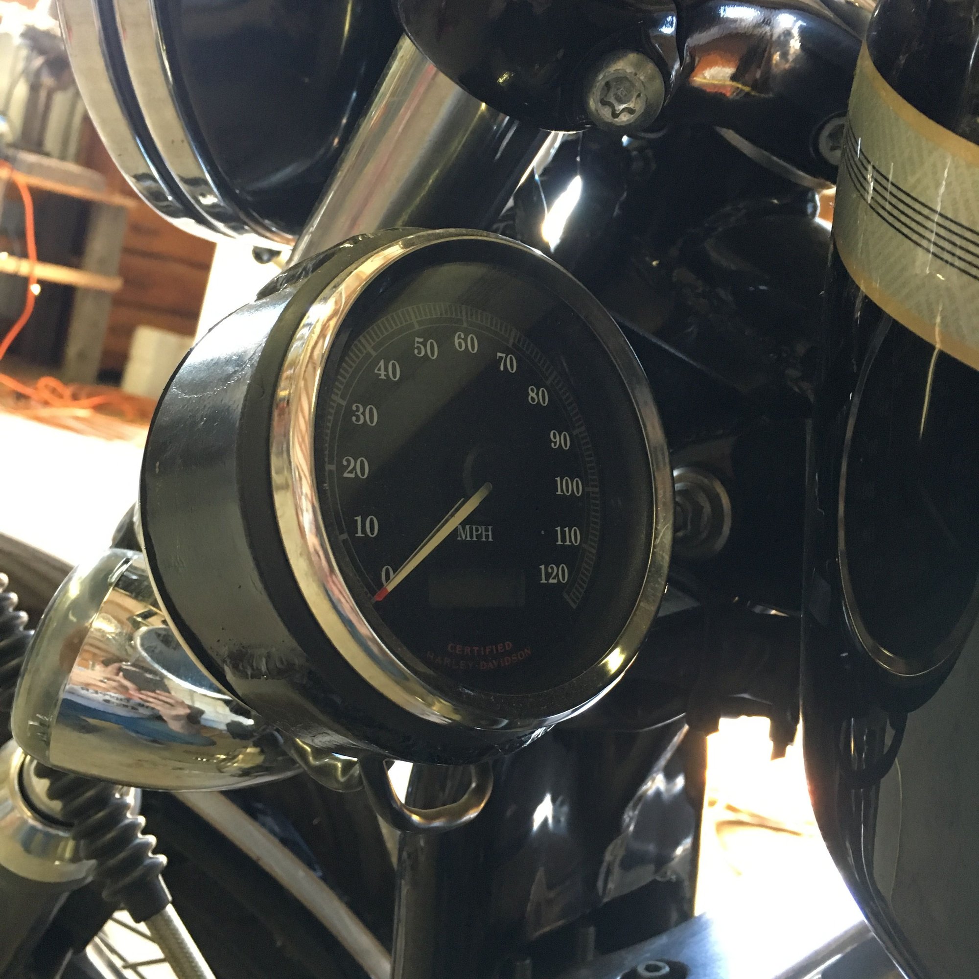

And my speedo holder that I made. At attaches to the bolt that holds the gas tank on up front.

@jmann8686
Very cool stuff. I like the utilitarian aspects to the way you fab things. Keep at it!

Those bars look professionally done, really came out nice.
Thanks. They were actually pretty easy to make compared to my first set i made. The way I made them this time I was able to lay everything out flat. I had the bottom part made and the top part made. Then went home clamped the bottom part on to the bike sat on the bike and held the top part onto the bottom and figured out where I needed to weld it. Then marked them in two or three spots and then went back to my dads house where the welder was at and tacked the together and went back home made sure they were where I wanted them and then welded them solid. They have been a good set of bars. I really like the way they turned out. They were a pain to run the wires through. Luckily I only had a few wires to run.

Originally Posted by jmann8686
here is the fender bib I made for the bike. It is my first one. It needs to be about 1/2 thinner and about 1 to 2 inches longer. But for a first go I think it turned out good
I can get better pics later tonight but in this photo you can see the pedal highway pegs. The mid pegs. part of the bars, and the sissy bar installed on the bike before I put the fender bib on.
I can get better pics of the bars and the speedo and the plater holder and some other things I have made for the bike
That is some seriously nice leather work you did.
Cool sissy bar also!

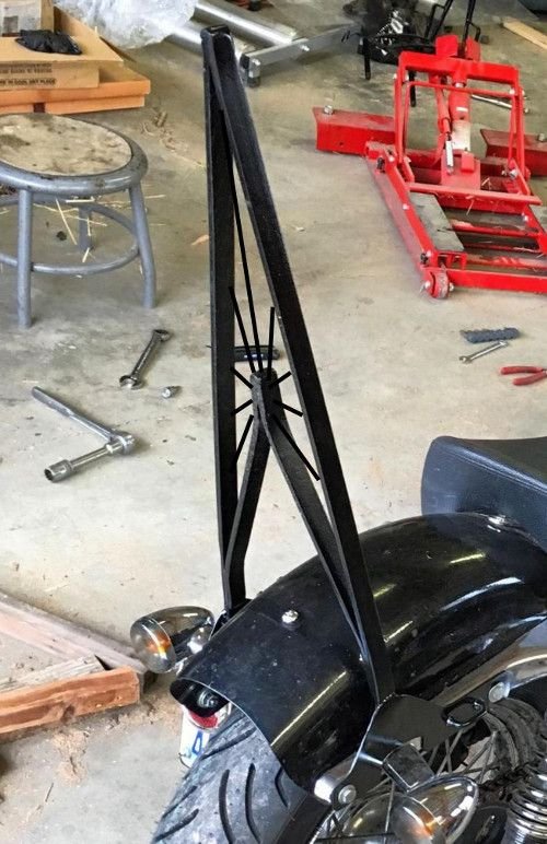

I second this. Though I confess I was picturing some sunburst spokes coming off the inner section of the sissy bar and radiating to the outer section.
Well that would look awesome. I like that Idea. one a rainy weekend I might just have to take the sissy bar off and grind some paint and do a little welding. I like that idea. Thanks,
