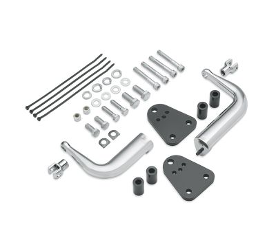

I just bought this kit from HD to install highway pegs so I can stretch out. It is installed where the forwards go (I have mids)

I have a SuperLow with a crashbar, but that is too far away for my legs to reach. I bhave the same peg kit as hscic, adjustable to three different locations. Looks neat and works fine.

Part no. 49053-04A. Not sure if it comes in black. If not just paint with a high temp black paint since it is next to the head pipes.
