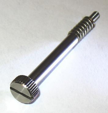

I bought and use these...
http://cv-performance.com/ez-just-mixture-screw
http://cv-performance.com/harley-idle-speed-screw

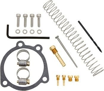

Going to use their Kit to tune the carb this Winter.
http://cv-performance.com/Shared/Ima...rs_kit_med.jpg
Will order a new diaphram and slide
http://cv-performance.com/harley-vacuum-slide
