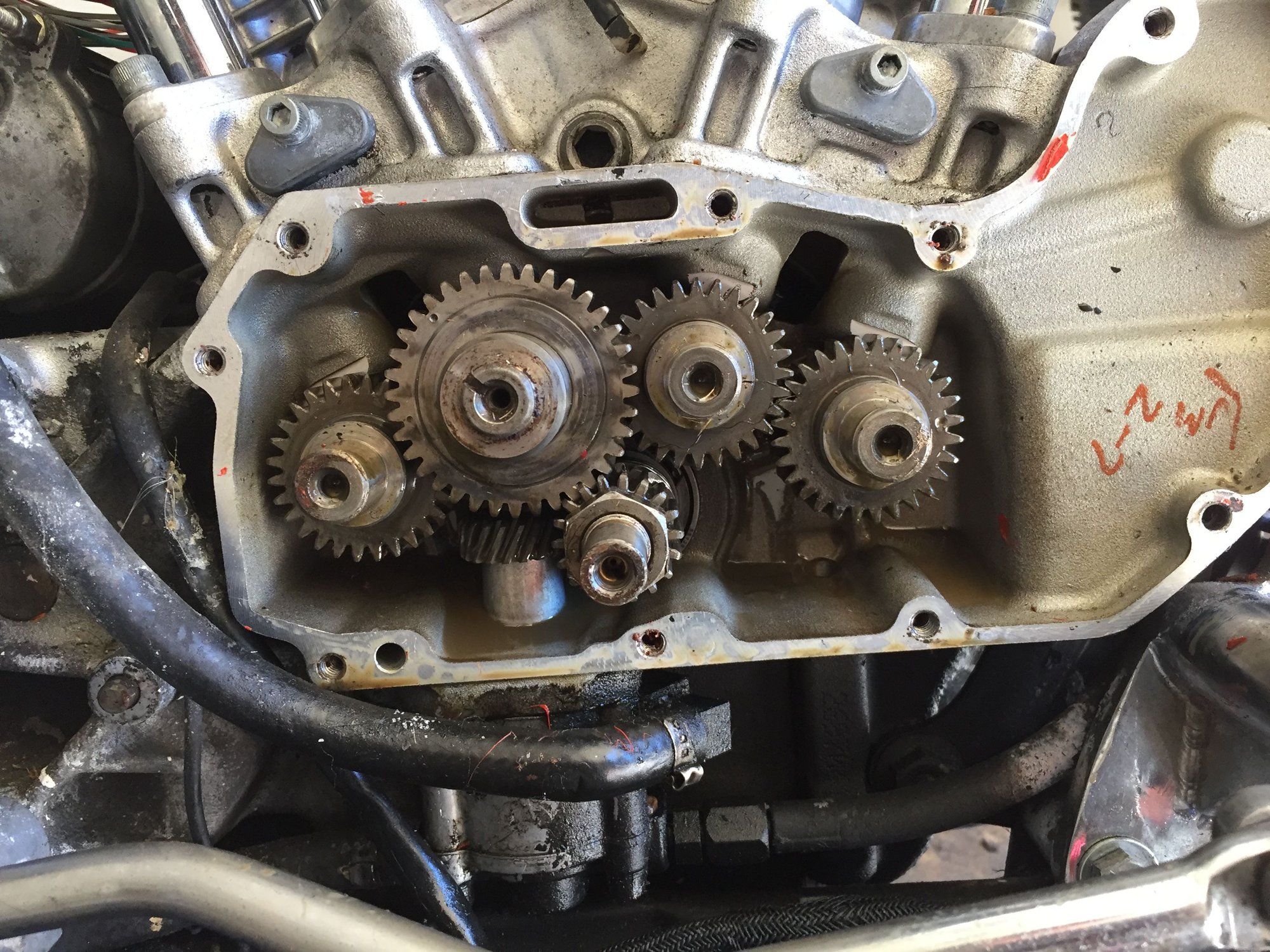

Ok, removed the cam cover, hit the start button for a second just to see, and the shaft is turning, so that's good. Also took a picture of the cams just too see if there is anything wrong you can see,

Also pulled the bolt off the shaft, and once I did I saw that key that goes in the slot is broken, which makes sense cause when I hit the start, the shaft spins but not the cams.
