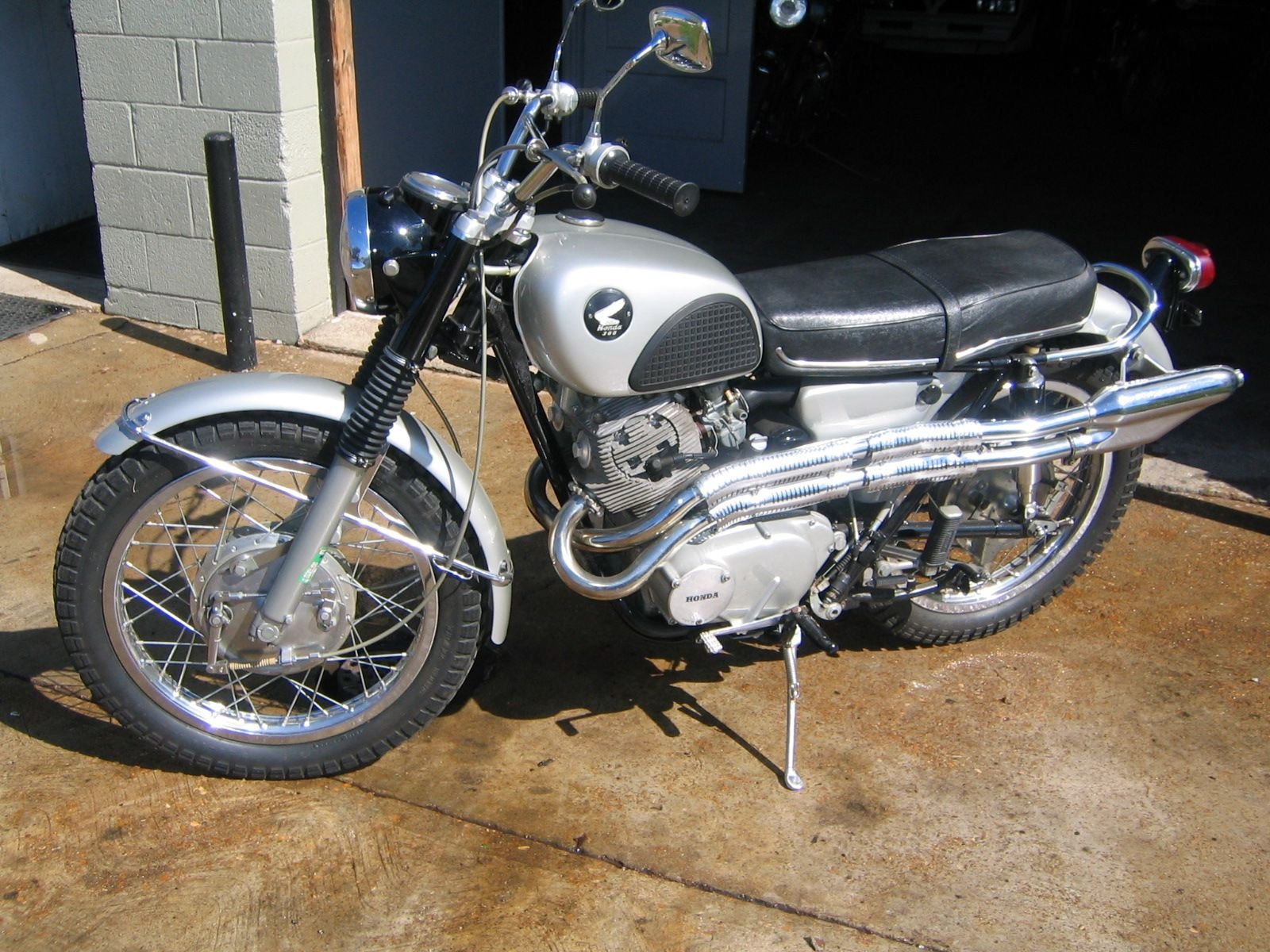

Originally Posted by JayTee2015
Yes. ..
i agree. . .
And. . you mean bike prices like these ? $4,200 to $7,400 . . .
https://www.smartcycleguide.com/L49965187
https://www.smartcycleguide.com/moto...-305-scrambler
And one of the reasons clean ones are so expensive is that there are so few clean ones. But lots of butchered wrecks.
