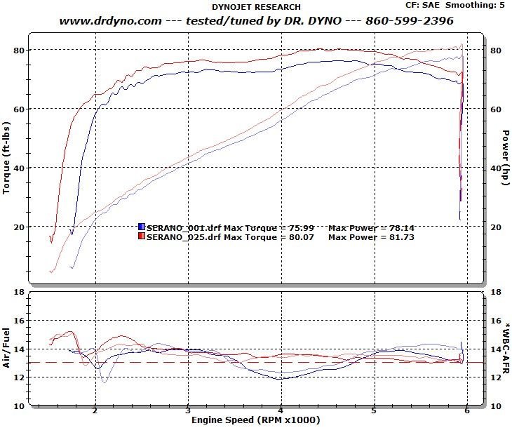

It's been one week since I had my bike dyno tuned via my PCV.
I'm running SE II replica slip ons and a Hammer Performance 2" air cleaner. I ordered the PCV on eBay from Fuel Moto and they loaded it with a map for my setup. Can't say I noticed a big difference with the PCV, maybe the throttle response was a little tighter.
I brought my bike over to Dr. Dyno and he did a few baseline runs and said the Fuel Moto tune was pretty good. The AFR was a little out of whack which was expected when just approximating maps, but still much better than stock. The dyno tuner cleaned it up so that closed loop sits right at 14 during a cruise and between 13 and 14 during WOT.
He told me, and I've read all over, that a trick to eliminate decel pop is to give the bike fuel at 0% throttle, so he did, and he also increased the timing at 0% throttle. I do still get a pop or two every now and then. Maybe 5 during my 20 minute ride to work.
Today was my first fill up and I was at 37 MPG. I have recently been hitting right around 42 MPG and that includes pre and post Fuel Moto map. I don't think I ran it extra hard to kill 5 MPG. Same routes and style except maybe one or two hard runs to try and see a difference pre and post dyno.
The dyno tuner only adjusted the fuel tables and the timing as I mentioned earlier. Not sure what else there is that could be changed.
Here are my charts for cruise (didn't run at the same throttle positions) and WOT.
For cruise, blue = Fuel Moto, red = stock, green = Dyno Tune
For WOT, blue = Fuel Moto, red = Dyno Tune
- What's the fluttering at 2-2.5K?
- Assuming the dip around 3.5K is from my slip ons?
- Didn't think I should expect such a drastic drop in MPG. I do get a strong gas smell when I start it up and it does seem to idle higher until its up to operating temp.
All in all, I almost prefer the Fuel Moto map.

Hey ripto thanks for this post. Interesting. I have read almost all the stuff from Dr. Dyno he seems like he knows his stuff. I would like to see your AFR and Spark advance tables. I am sure he probably adjusted your VE tables. Do you have the stock O2 sensors or did you add the VB sensors? I asked because if you have the stock NB sensors I am curious is to how he set a 14.0 AFR to run closed loop.

To be honest, 14:1 at cruise is super rich, no doubt you're getting jack gas mileage. No need to be that fat at super low throttle openings. You can run 14.5-14.7 and experience no ill issues while keeping good mileage.

It does feel like it reacts better when I twist the throttle going from nothing to Fuel Moto. From Fuel Moto to Dyno I can't really tell much.
I watched him do all the tuning, he adjusted the fuel cells throughout the RPM/throttle position chart. He did about 30 or so runs to get it to that 14 AFR. Those are the only two charts that I have, the power numbers and the AFR. I have the stock O2 sensors but you disconnect them with the PCV, so right now they aren't hooked up to the ECM.

That's not really the case though. Look at the Fuel Moto runs. They are richer than the dyno tune runs.

If you are not running wide band O2 sensors then your always in open loop at an AFR of 14.0. There are tons of post on here about this check them out. But any cell in your AFR table not set to 14.6 is open loop. Unless you run the same gas all the time you Dyno tuned your bike too you could potentially run alot leaner than 14.0.

Don't those two AFR charts prove I'm not always at 14.6?
