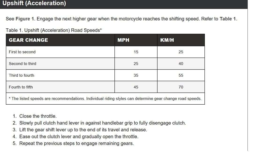

from my bike's manual

14, that table is way too conservative.

Yea, it's meant as a recommendation during the break-in period.

I usually shift at 10mph above what the table shows.
