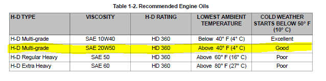

engine
you can put whatever oil brand you want in the engine hd reccos:
dino or synthetic- again whatever you want..
some folk put car oil in, i don't but i'm not saying it's wrong... there are ton of oil threads out there ... lets not turn this into one

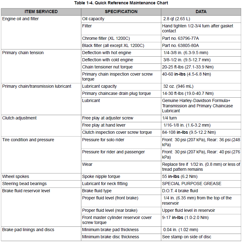

primary
Hd says formula+ or syn3... i've ran both and am happier with mobil1 75w90
again totally your call. none will cause a failure
filter
same story.. you can buy hd's or grab whatever pops up on the cross reference at your local auto parts store like the kn-170 and kn-170c

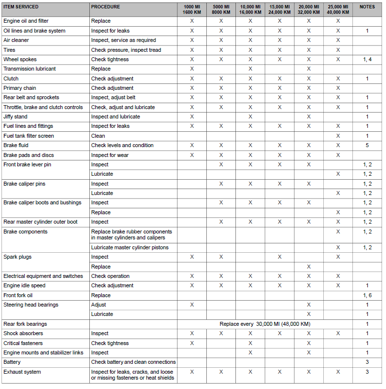

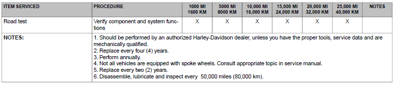

here's the maintenance schedule:
have fun... get a service manual when you get around to it.
