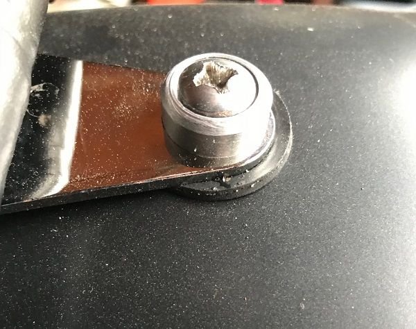

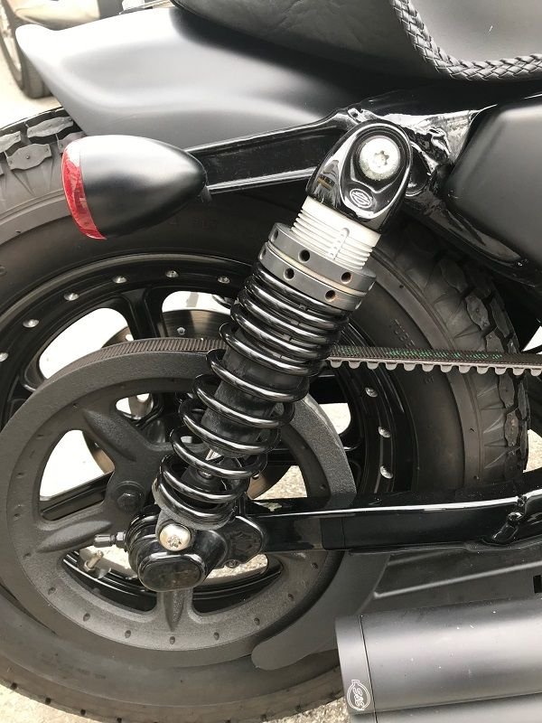

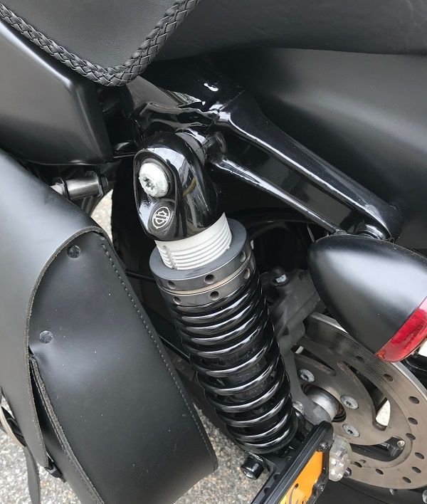

so i switched out the stock 2014 shocks on the 48 to street glide premium adjustable shocks, too stiff. today i put on a set of the 2017 sportster emulsion shocks and it made a big difference. smoother ride, no bottoming out. also after noticing i had a couple of gouges in my rear tire due to the seat screw when bottoming out with the stock shocks on the nyc highway speed bumps, we fabricated a spacer and everything is all good now. bike is smoother and screw doesn't hang out under the fender anymore. next week progressive front fork springs, and ricor intiminators.

Right On! I like my emulsion "Roadster" shocks. I wanted mine to sit taller but didn't want to give up the "known ride quality" or spend a fortune, so I added Bung King lift blocks. Couldn't be happier. Actually a better ride than the '17 Road King I sold to do the sportster.
