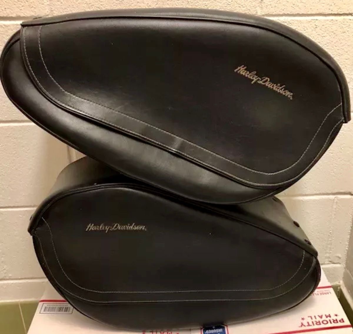

Looking for assistance regarding Sportster saddlebags.
Harley part numbers stamped inside each of the bags are 79056-01 / 79077-01 (right side bag) and 79055-01 / 79076-01 (left side bag).
What year and model Sportsters will these fit?? I can find no help online anywhere!

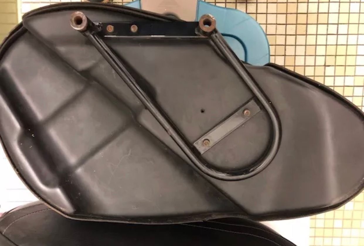

I have a 2003, 100th anniversary edition, XL1200C. The holes in the built in U shaped bracket line up, but the cut out for turn signals doesn’t line up. Is there a difference in the distance between the screws in the fender rail on the 883 compared to the 1200C?

The bags are correct for your bike, you need the turn signal relocation kit #68485-04. That kit is now obsolete thru H-D, but if you call a few close dealers they may still have the kit.

some online sites say that part number will work except for 1200’s. Others say works for all XL’s except 1200 Sport. So, if I find one I hope it works- it should since mine is a 1200C. I also have Harley side plates for detachable sissy bar back rest. Hope that doesn’t throw a curve into the mix.
