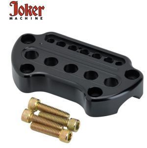

I may be doing this in the Spring as well, but I'll probably just use the Joker Machine front fork solution as it seems to be the most straight forward, albeit a bit more expensive.

I did it with a cheap Chinese bracket that I altered, on the risers I used the upper indicator clamp from Joker Machine.

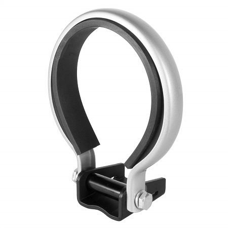

i too looked at moving it to upper clamp for my tank lift....didnt like it and all i had to do to get to work..........so i got the Autometer clamp, like 20bucks and mounted on side, yes visibility can be an issue for some, dont bother me tho, i can see it till bout 50ish mph

you can put spacer to bring it out more, i was ok with that, most of my riding is under that
