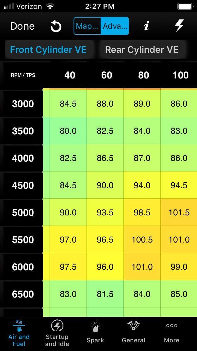

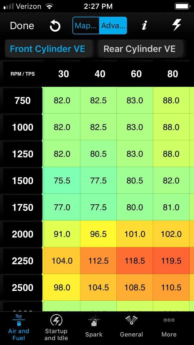

The issue is not with Fp3 module but with the Map from V&H and it's server structure..can you do me a favor and post the screen shots of the Acceleration Enrichment table of the current slot(0) Map and the V&H Map that was tuned for you.

These are the Volumetric Efficiency tables u posted..I asked for the Acceleration Enrichment table (it's a single column table)
Quote:
For whatever reason I'm not able to view the stock slot (0) map
Press and hold one of the empty Map slots from the View/Edit Map section. u'll get options to copy a Map from any other slot..select the slot(0) Map and then u can view/Edit the copied Map from there
Again need the Accleration Enrichment tables of both Maps not the VE's
