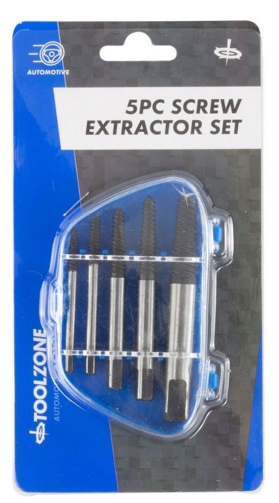

It might be worth trying a screw extractor set like the one below, a five piece set is available on Amazon starting at around $5.00 plus shipping.
I have successfully used screw extractors on my past motorcycles, even if you only use it once it will more than worth the price paid.
