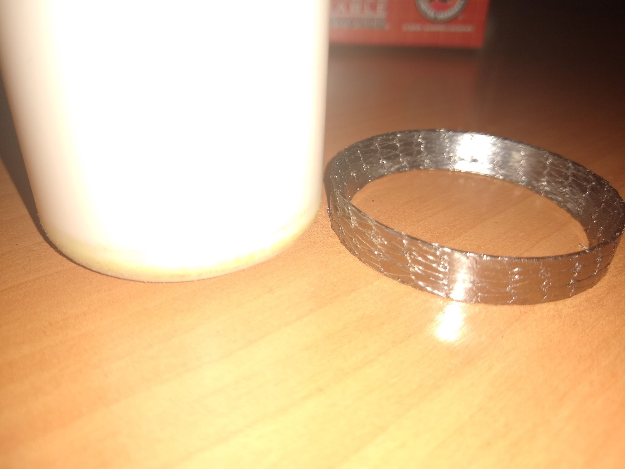

Ive bought Cometic gaskets in case I ever need to remove my headers . They are of the mesh taper variety . I've watched a few YouTube vids and the secret to success seems to be to press them in with evenly distributed pressure. So what you need is a a cylindrical object of a diameter fractionally smaller than the gasket . So far the best thing I have found is , believe it or not , a plastic bottle used to contain Frylite . I don't know what country you are in but in the UK this is a one calorie frying spray used by dieters. This may sound a little unorthodox but it looks very workable to me .

Well let me know how it goes, remember I haven't actually tried this yet . I would think that thoroughly cleaning the gasket seat and smearing a little oil on the surface might help too Good luck .

After all that preparation I didn't need anything to push the gasket in . It slipped in nicely with gentle finger pressure . So my advice is to buy Cometic gaskets . Simple as that .
