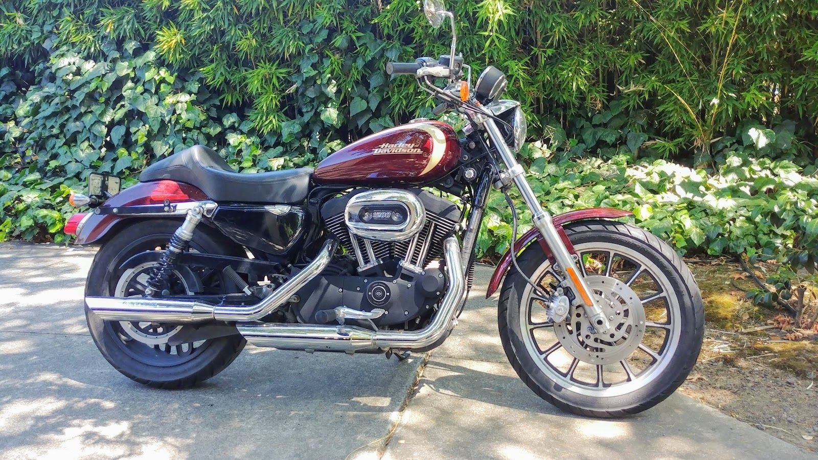

I did the LED headlight and taillight on my 08 1200 Roadster and they are a big improvement plus safer since the stoplight illuminates much quicker than an incandescent bulb...but wouldn't bother going LED on the TS bulbs. Installed the HD SE fully adjustable cartridge fork kit and like it, went with basic Ohlins in back and they work well too. Also installed a 16+ Roadster rear wheel in back so I could go to 18" and run better tires AND because 16's don't look right to me on a Sportster. Unfortunately the matching front wheel won't work with narrow glide forks. I'm happy with the stock dual disc front brakes as is. Running Pirelli Scorpion Trail II tires front and back and they work great wet or dry and on dirt roads.
