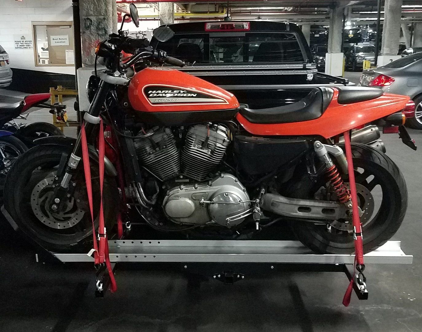

One because I been around bikes and trailers a while. You need extensions even for bicycles in many cases. Any extension to the hitch is automatic 50% reduction in weight. Do the home work etrailers is a good place to find video and information.
If the carrier is extended when you buy it the reduction is still required.. A simple basic one bike trailer would work much better in the long run.
I'm not disagreeing that use of an extension reduces that capacity of the carrier. And that IF he needs an extension the carrier above will not have enough capacity to haul a Sportster.
But, I think a Sportster will fit on the Sportbike carrier linked above just fine behind a 3/4 ton pickup truck. That's from looking at the measurements of the carrier and the back of my pickup truck.
Sorry unless you can show me a picture of that carrier on the back of a truck and a Sportster not fitting on it I choose not to believe you.
Simple solution, the OP could contact the carrier company and ask them if a Sportster will fit.
Watch the videos on the web site. They aren't using an extension and it looks like there is plenty of room on there.
and if you look through there customer photos you can find a picture of a Sportster on one of their carriers, and also a Honda Shadow, as well as lots of sport bikes and dirt bikes.

welcome to the forum from Colorado. I dont believe the 1200 is all that much different from the 883. The dry weight of a 1200 is 549lbs . Add 24lbs of a full tank your still in the 600lb threshold so your good.

That is actually a Honda Magna. Its a V4 engine sitting crossways in the frame. Just being technical. Weight specs for the Magna are very similar to the Sportster. Still not sure I would trust my sporty to a single point of hitch with all that weight on it. I have seen more than one of those receivers break from tongue weight.
