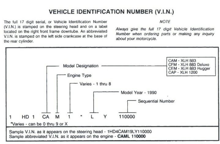

Hi all , I have just bought a chop with a Sportster engine Number CAPL112828 can any one help identify the modal and year of the engine so i can get the correct parts for its rebuild . thank you in for your help Phillip ps HD newbie

Old Mar 4, 2020 | 08:12 AM
RKZen's Avatar
RKZen
Joined: Aug 2013
Posts: 6,089
Likes: 1,962
The motor number could be some form of the actual VIN. CAP could be the model using the 5th-7th digits in 1986-1996 H-D bikes. CAP=XLH1200 and the L might be the year, L=1990. The last 6 digits of the VIN could be the those 6 digits you have.

Last I knew the engine number was an abbreviated VIN [anti Theft thing]
but I sure would like to see these numbers that Indicate a CA= XLH1200, or maybe an XLH 883, P,=1200 EVO, L=??? possibly a 2001...
Yes... Could also be 1990... I agree!!! HD changed the VIN "pattern" in 1970, then again in 1981, and yet again in 2001!!!!!
easy tho... is it a 4 speed or a 5 speed???
CAP = XLH 1200
L = 1990
The last 6 digits are production numbers.
