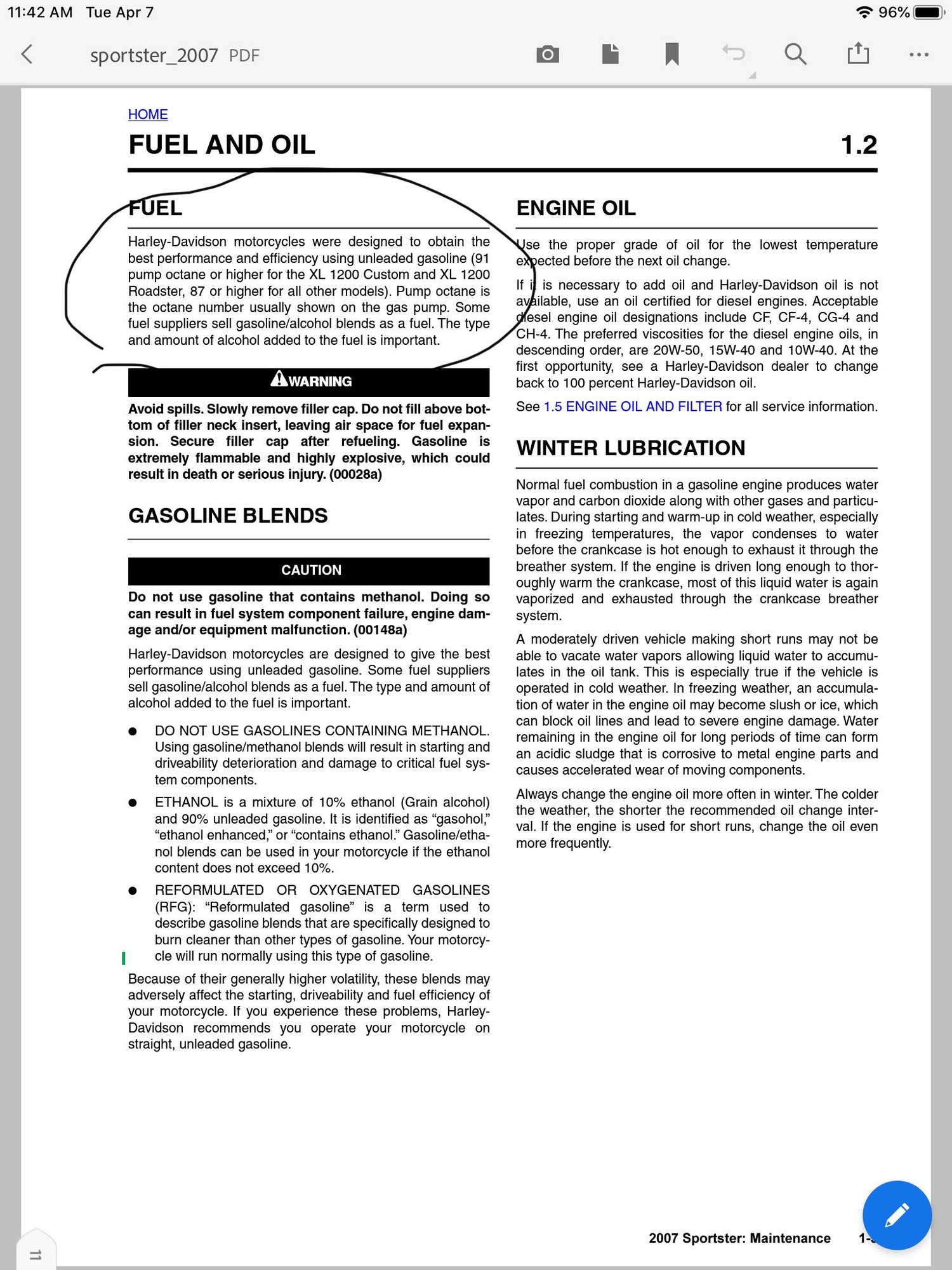

Here is what my manual says. Note: the only 1200 models listed that REQUIRE it are the Custom, and the Roadster.

Originally Posted by handirifle
1. Here is what my manual says. Note: the only 1200 models listed that REQUIRE it are the Custom, and the Roadster.
2. So the UK pumps have a different hose for EACH octane rating of fuel?
1. The 2008 and 2017 manual call for 91 (95 RON) for all engines.
2. That is correct.
