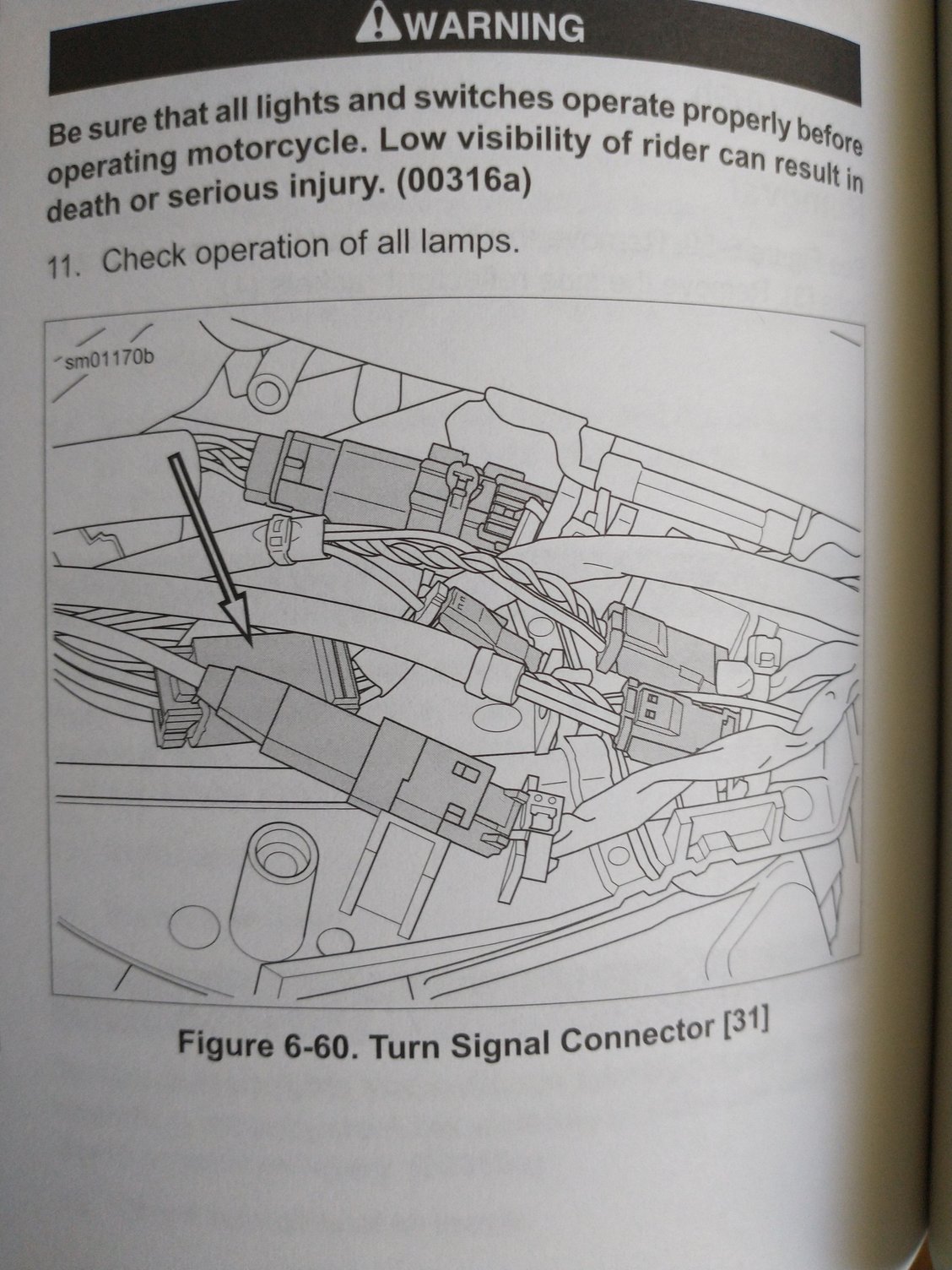

They connect under the gas tank from the manufacturer so youre going to want to remove the gas tank to find them. If you plan to work on your bike I highly recommend, as many others do, that you get the factory service manual. if you only plan on doing this one thing and you arent a hands on person (but then wiring probably isnt something you should be doing) then google can get you by.
PS: Id go for the harley manual over the clymers, I have seen too many major issues flagged in clymers manual like telling people to turn the crank the wrong direction for valves (suzuki ls650). I just always second guess whats in the clymers, the HD one I take as a bible.
https://www.hdforums.com/forum/sport...al-wiring.html
Here is a picture from my 2014 manual. I have read "6 inch down from neck under the gas tnak" but that was before canbus so it may be a bit different but thats where the wiring will run.
