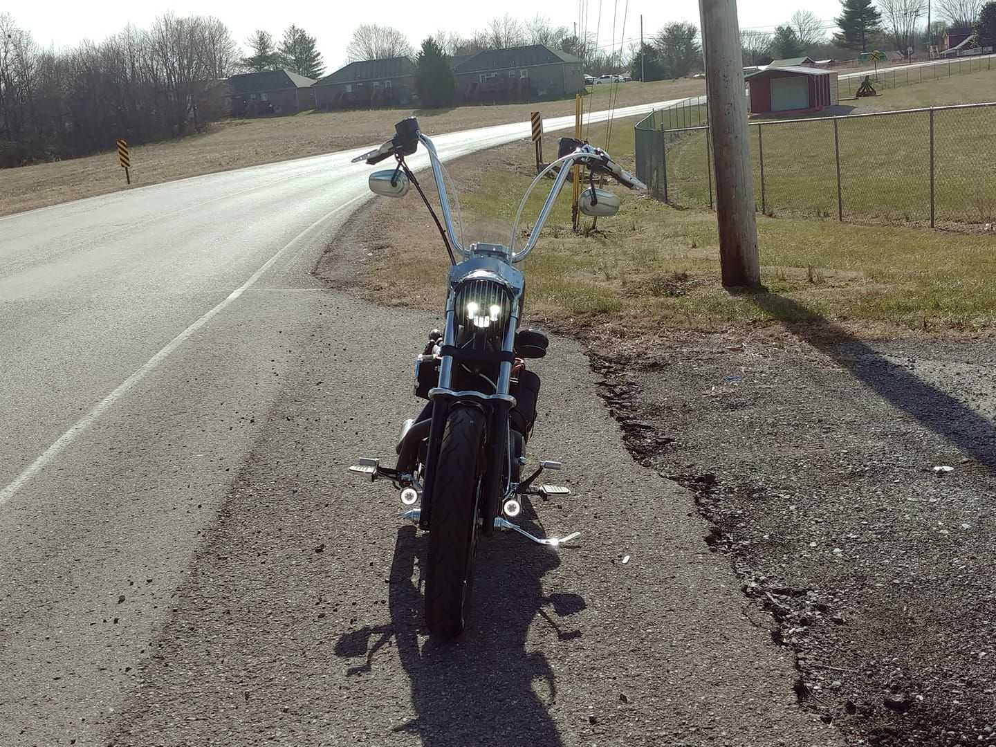

i made my own bracket and dropped mine down low.cars seem to see me better now that i have a large triangle of lights.
