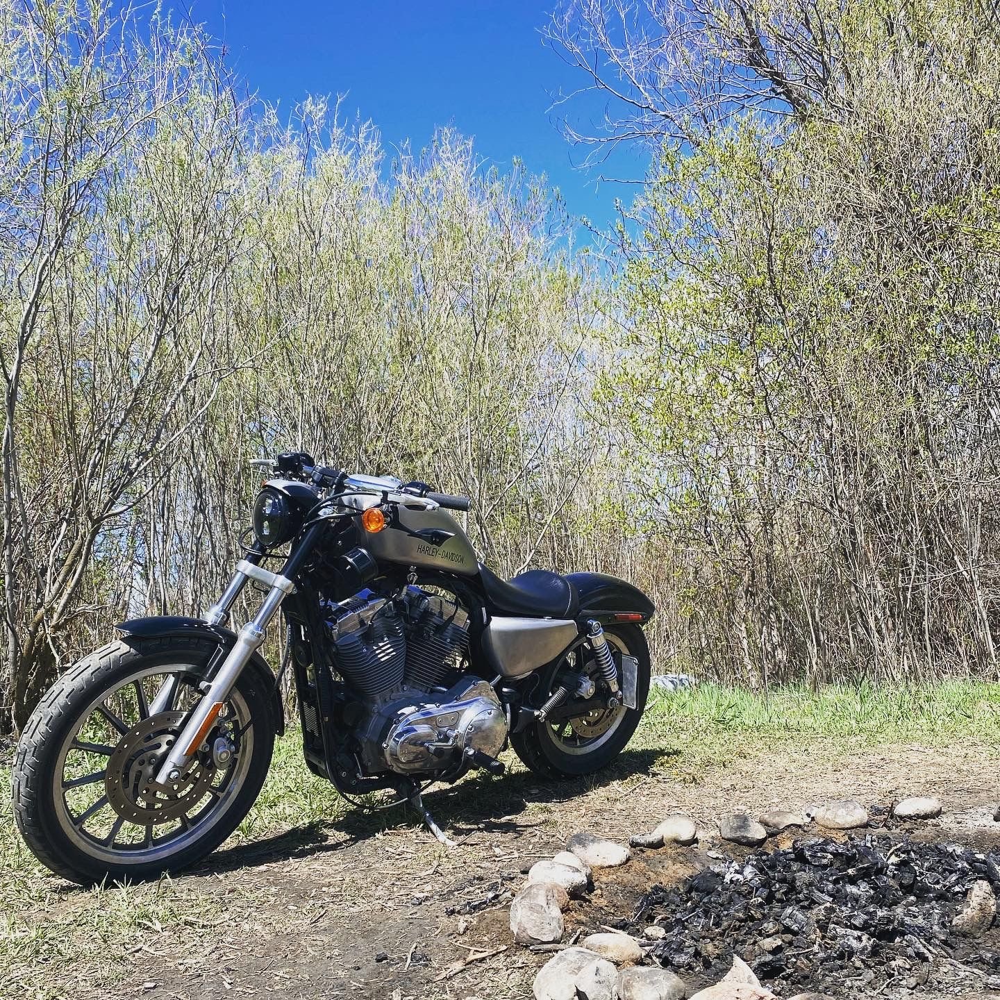

Here’s a pic, for my first bike I’m definitely happy with how it looks
