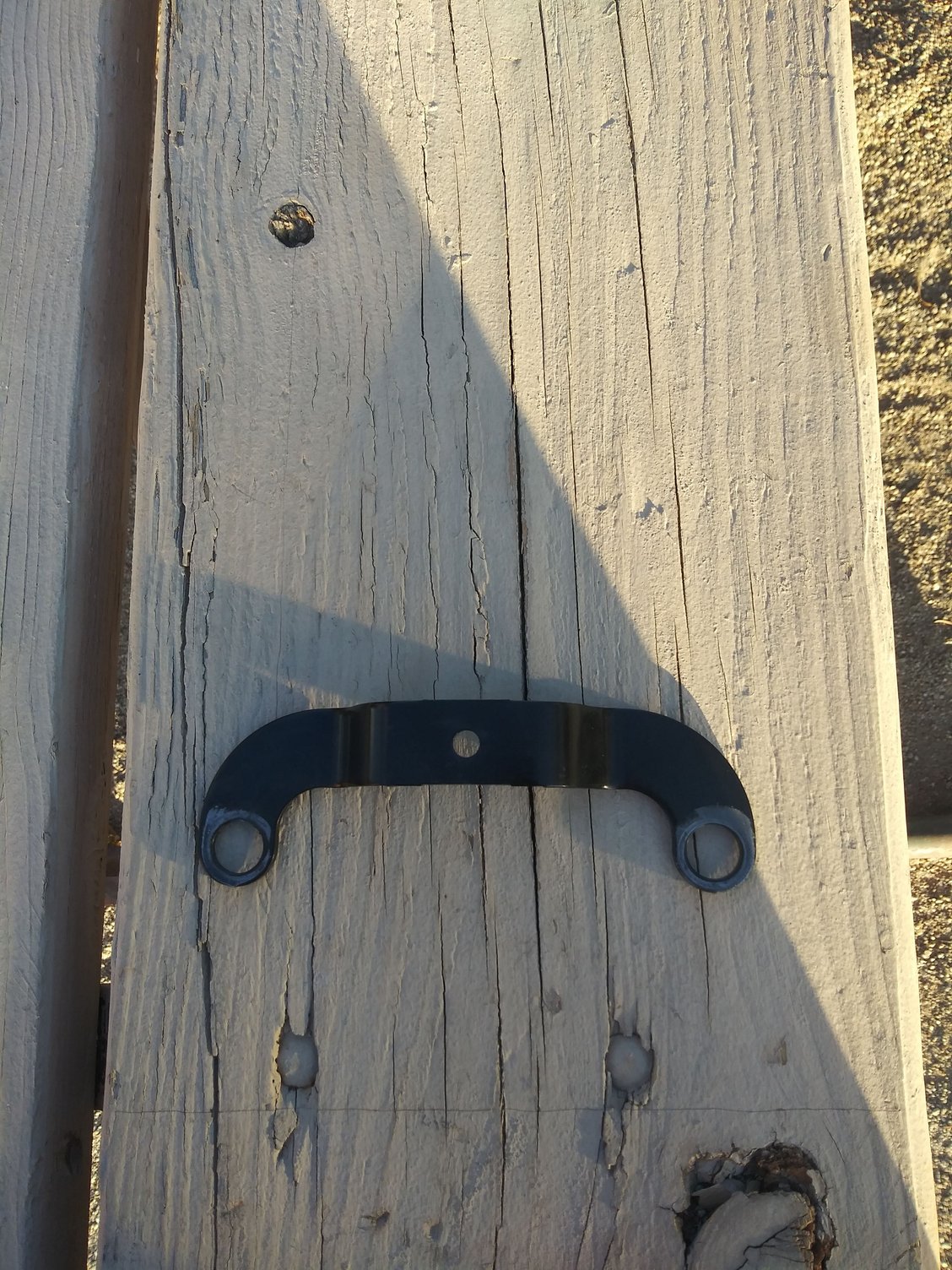

Is the SE rubber spacer installed between the filter and the ham can? If not they are available separately...
yes put it turns out the old bracket was left on

I have the same setup on my bike. It has been installed for 14,000 miles and has not cracked or broken.
What old bracket was left on?
Were these instructions not followed?
https://serviceinfo.harley-davidson....5?locale=en_US
The cover screws are literally finger tight. Have they been over-tightened? 30 to 60 in-lbs 5 ft-lbs max.
this bracket it was a parts manger that realized it due to not hearing or the cracking before and know the kit and installing them

I don't recognise that on that side of the bike.
