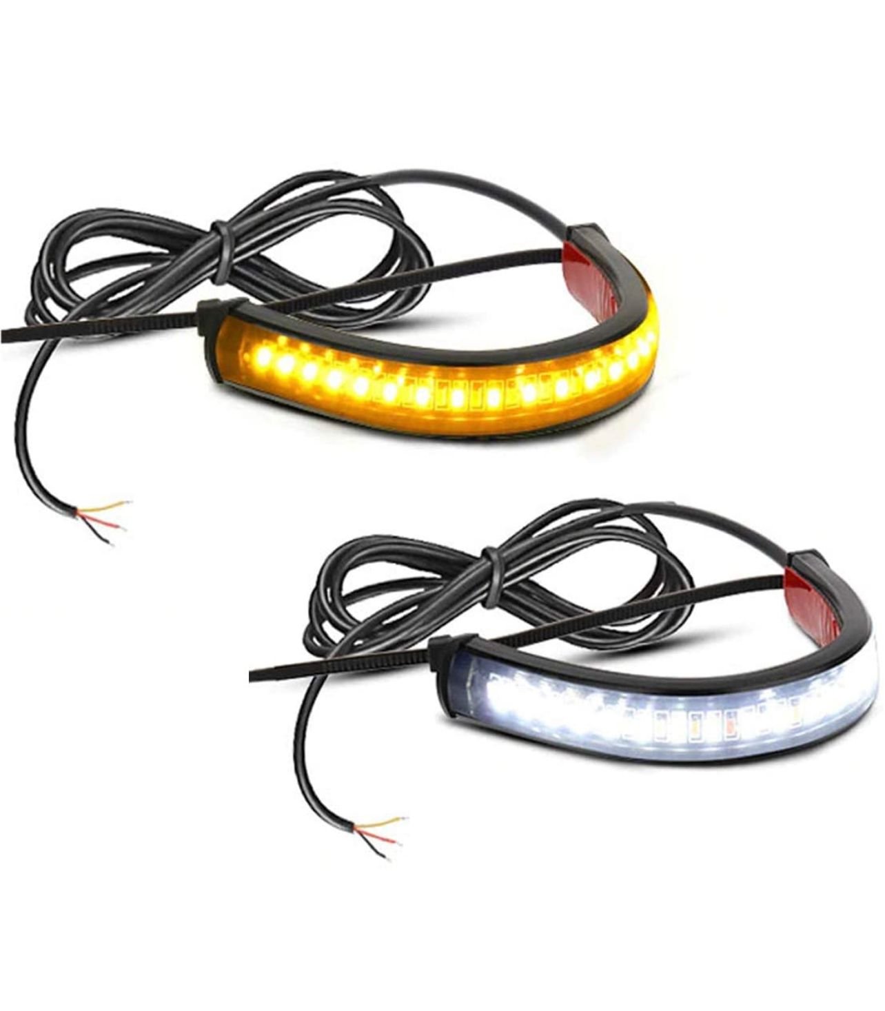

So i purchased a 2016 sportster seventy-two and it does not have the front turn signals or wire harness, i have some led strips that have running lights and turn signals that i would like to put on anybody have a wiring diagram of where the harness would come from or where i can run the wires from, thanks in advance i have attached a picture of the lights i would like to install

Why were the indicators removed?
I hope some nit wit didn't just cut the plug off.
The connector is under the tank. It is a multilock 070 connector 6 way.
Available from a HD dealer or a good auto shop or electronic supplies or even ebay.
Really useful connector part numbers - Harley-Davidson Riders Club Great Britain (hdrcgb.org)
Wiring diagram - 99949-16_en - 2016 Wiring Diagrams (harley-davidson.com)

not sure why they where removed but i want to throw some back on for my safety, and to avoid getting pulled over
cool thanks for the info so far its been really helpful, i will check under the tank once i get home from work and see if the connectors are there, those links you sent really helpful and full of info
