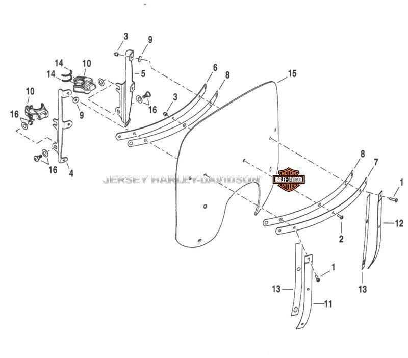

Just bought a ‘16 XL1200T which normally comes with factory windshield but my bike didn’t have it. Does anyone know what the original HD PN is? Dealer is not sure. Also looked at National Cycle brand which has one for the 1200T. They make quality products as I had one of theirs on my VStrom 650 and it worked well.

The XL1200T windshield itself is H-D part # 57400245, there are many other brackets and hardware required to mount it.
Do you want a list of all the mounting parts and their numbers?

Thanks Rob - so there’s not 1 PN that includes everything? Did you ever own one?
Sorry mate, the parts list that I have doesn't have a part number for the complete assembly, it itemises every individual part separately.
However I've found the part number for the complete windshield assembly, it's 57400322.
No, I've never owned an XL1200T, I have a 2011 XL883N, I don't like polishing chrome and there's acres of it on the XL1200T.
Here's an exploded diagram of the windshield assembly.
I hope I've managed to assist you.
Yes, this is a big help! Thanks Rob Roy
