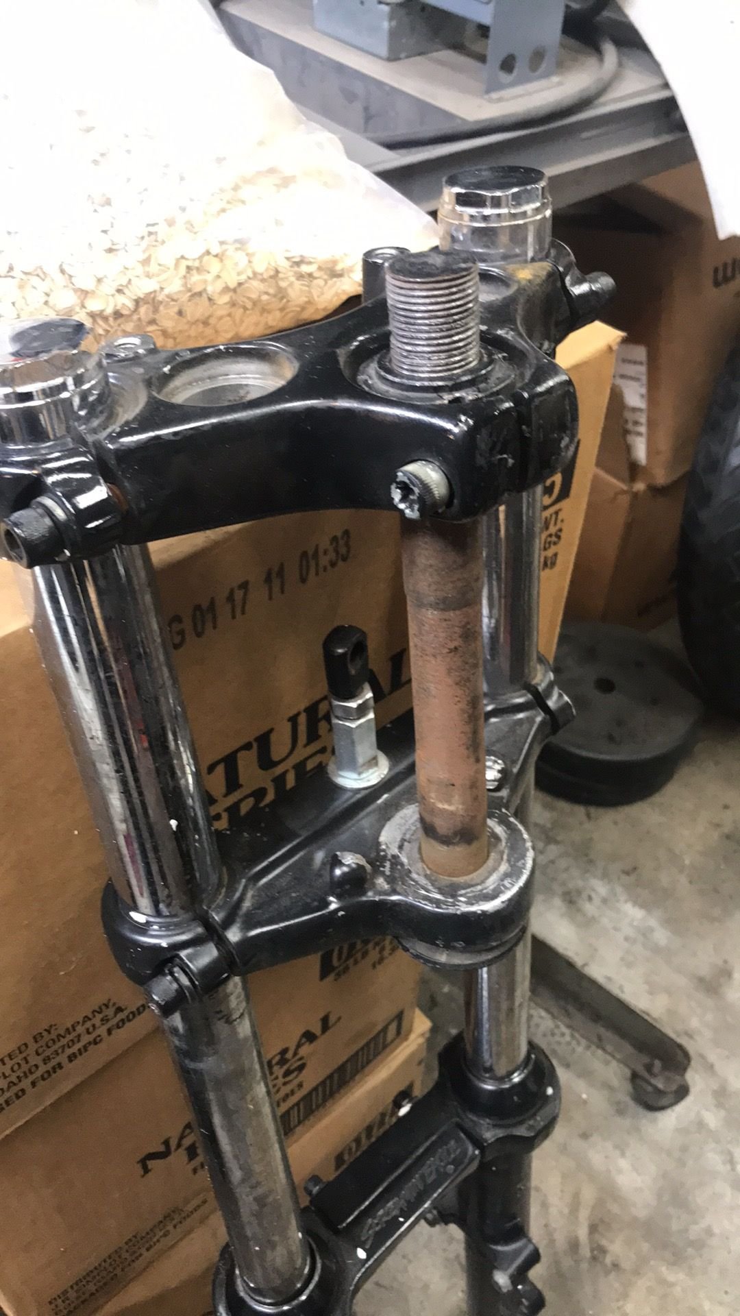

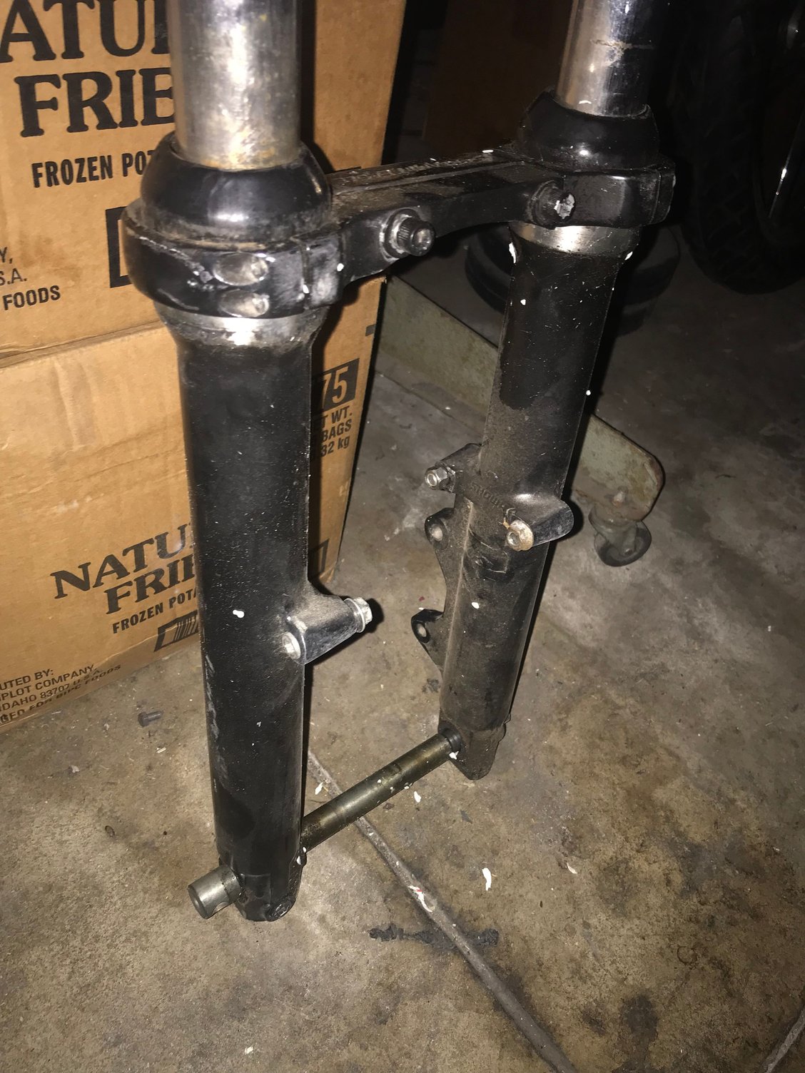

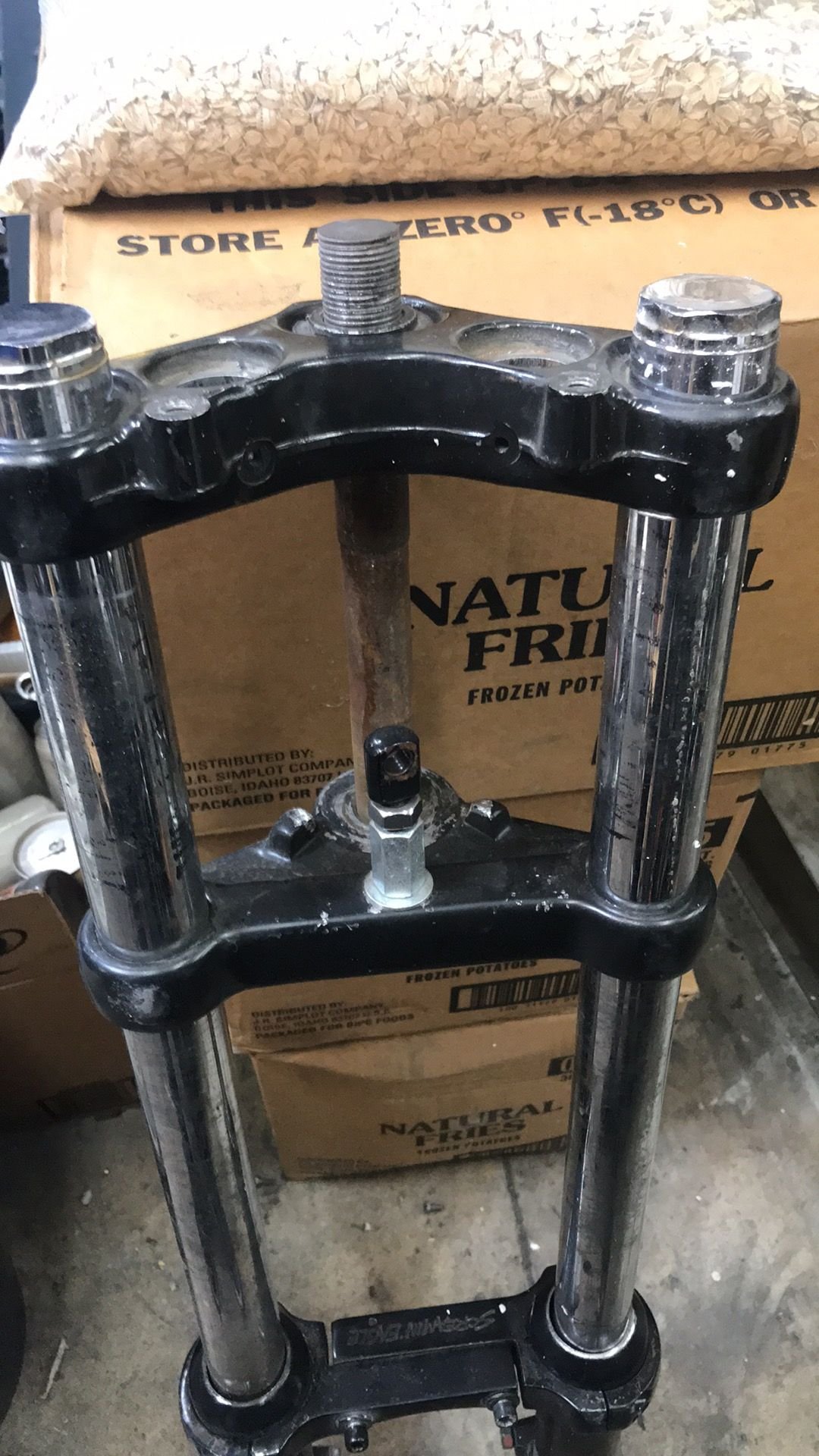

Hope someone can help me identify this front end..... Id like to know specially what year, model sportster it is from.
What i know:
Dual brake set up
3/4" axle
39mm fork tubes
the lower tree does NOT have the lock loop
ill upload some pics next.
thanks in advance

Dual caliper mounts but no preload adjustment, black lower fork legs, should be from an 883R model year 2005-2007 (if it is stock) with a 3/4" axle.

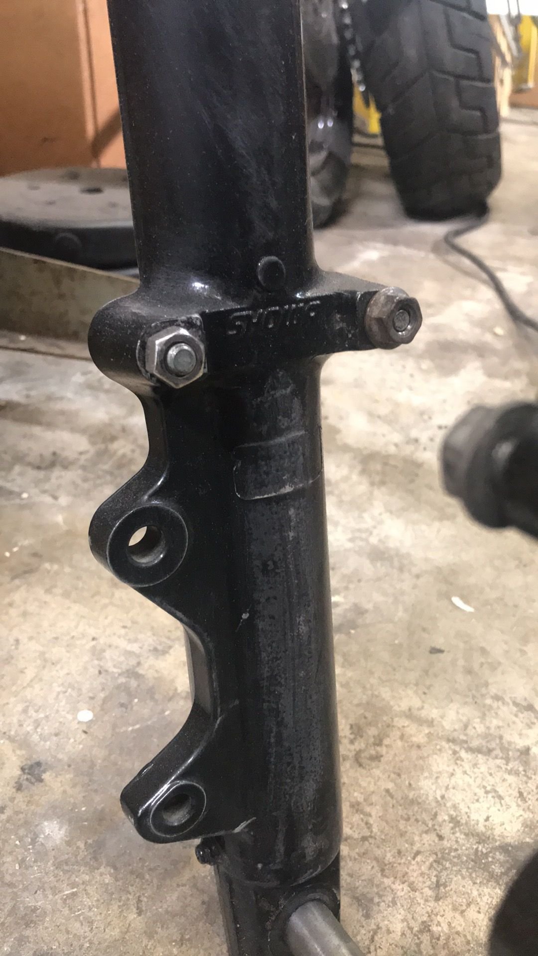

Does it have a part number on it somewhere?
Can you pull the bearings out and get a picture and/or a part number?
Couldn't they also be for a Dyna?
Or 1200R.

Thanks guys for your answers. I don't see any part numbers on this anywhere. Is there anywhere in particular I should be looking? It didn't have bearings. What you can see is all I got. I want to get the calipers, wheels etc. Just not sure exactly what years I should be looking in.
Of the Sportsters, I think the 2002-2007 883R and 2004-2008 1200R had the same forks. Not sure on the Dyna FXDX, but 2000-2004 at least.

On the assumption this is from a Sportster, I believe only the 05-07, i.e. carbed AND rubber mount, had black lower fork legs.

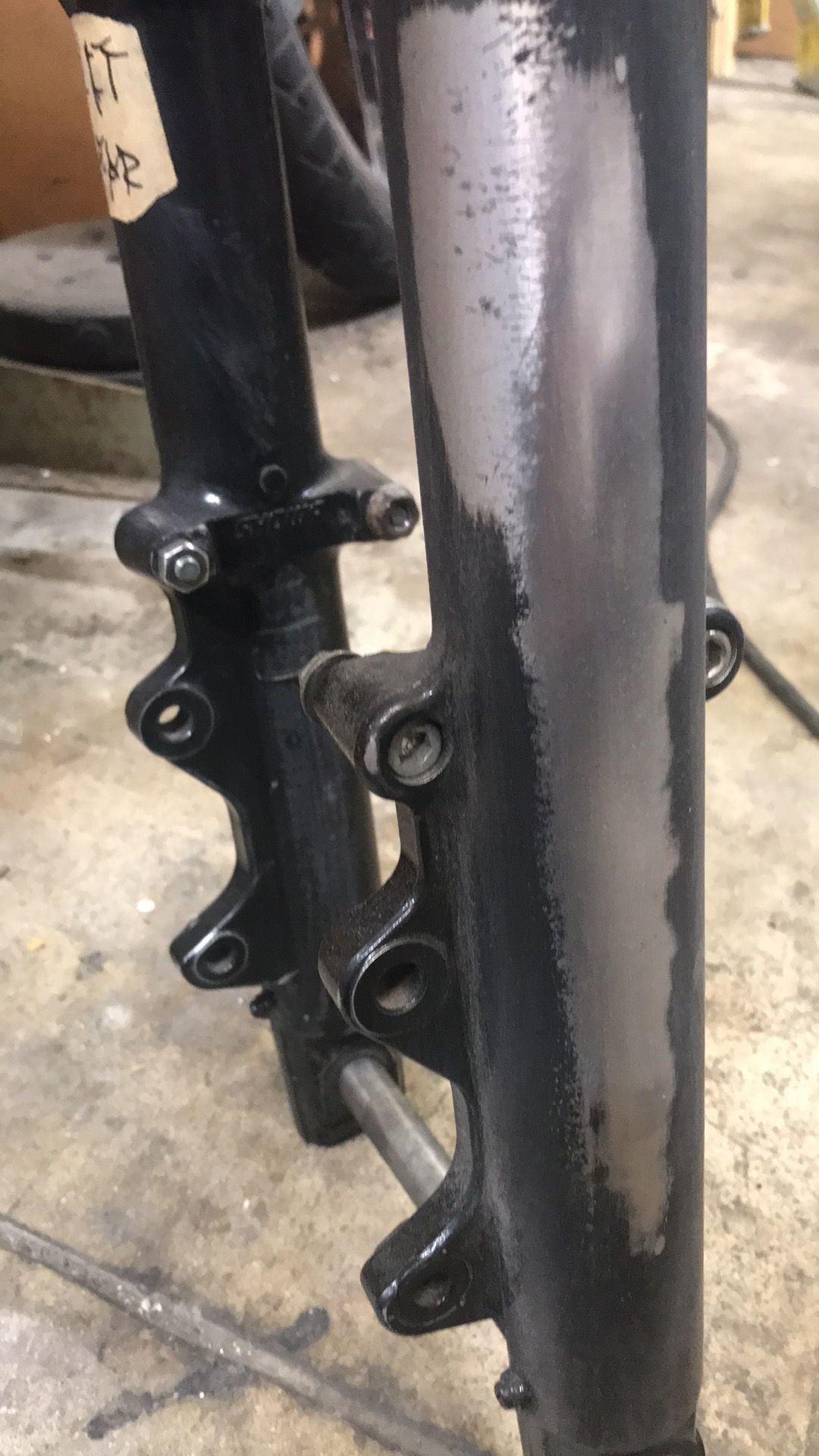

Looking at this front end im gonna have to say it was painted black , i could be wrong but looking at the marks and stuff id say painted , as far as year and stuff not 100 percent sure on that
