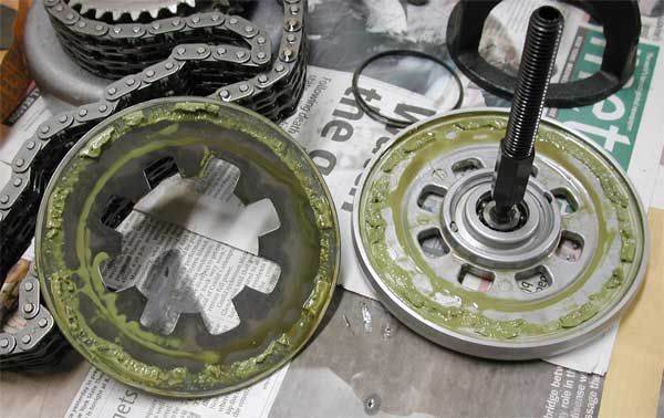

Do not use it in a Sportster. Heres why.
Redline heavy shockproof - The Sportster and Buell Motorcycle Forum - The XLFORUMŽ

Simple answer . . . NO! That "shockproof" stuff is for Big Twin TRANSMISSIONS. IT WILL F UP YOUR CLUTCH.
