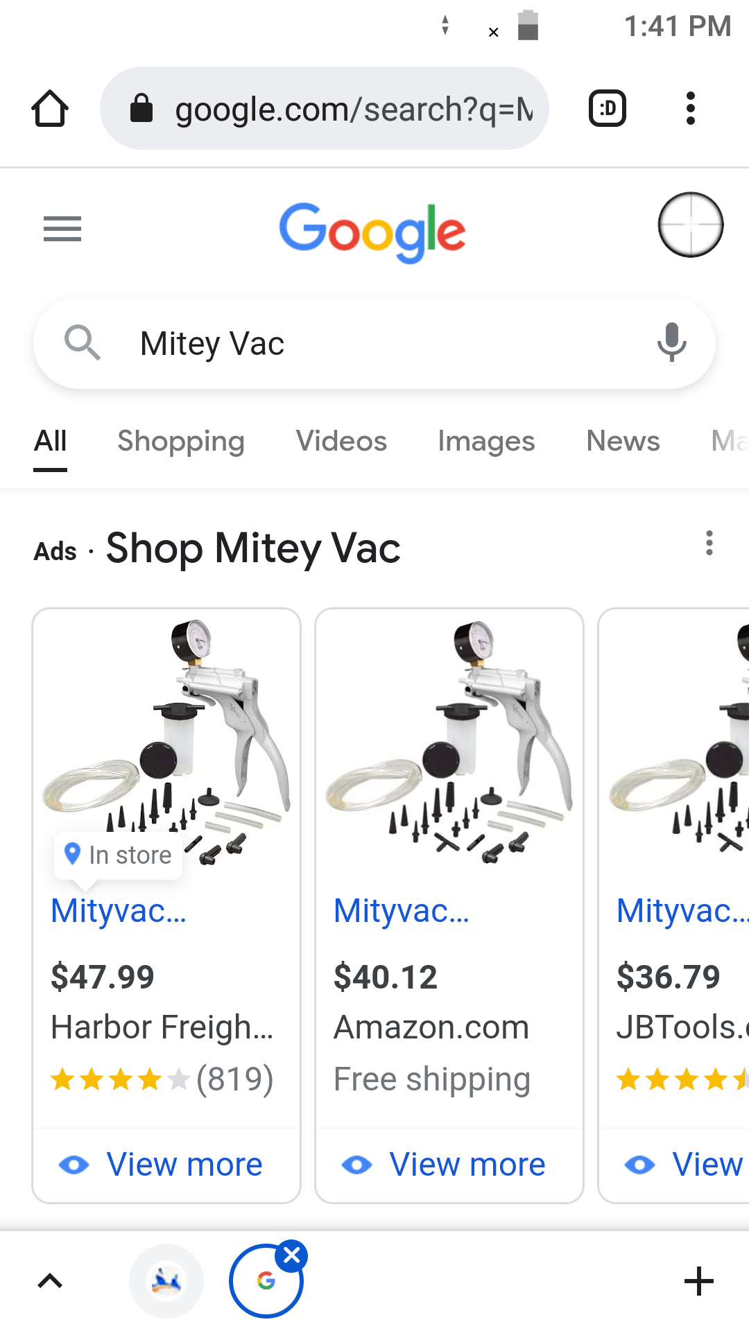

Get yourself a Mitey Vac. Soo much easier bleeding. I think that shop should have tested the brakes. A new tire has zero effect on that. Sounds like they screwed something up.
