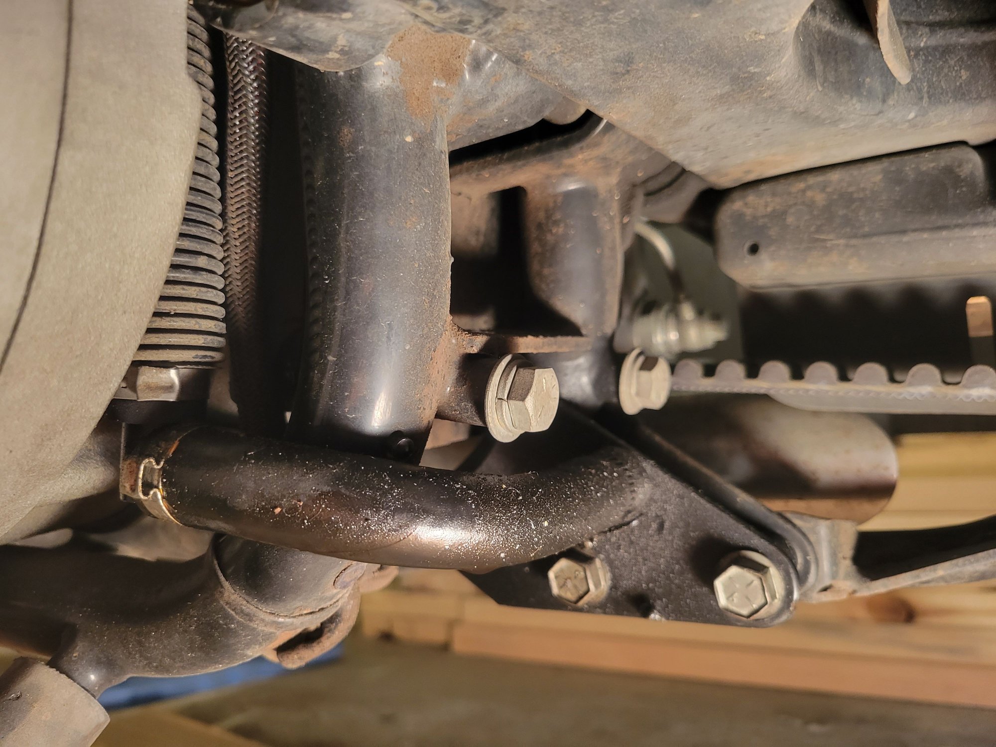

So the biggest leak seems to be at the oil hose. There's no oil above or around it, so it should be an easy fix.

There is no clamp on the one end of that hose. Clean it up with some brake cleaner put a clamp on it and keep an eye on it for a while.

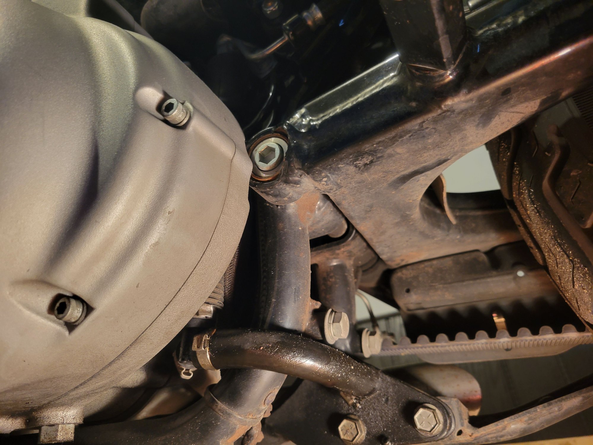

Actually, if you look very closely, there is a clamp there. You can see it better in the lower pic, the first pic you can just see the tag end of the clamp.
John
Old Dec 1, 2022 | 11:26 AM
BrokeWinger's Avatar
BrokeWinger
Joined: Jul 2022
Posts: 231
Likes: 100
From: WI
John
You are right. My eyes are going to ****, I'm sorry. I didn't see it at first. Maybe tighten/replace the clamp?

Yes there's a clamp, covered in oil and dirt.
I'm planning to change the entire drain hose with new clamps. It's weird that I can't find the specs on it but the advice I've seen is to take the hose to Autozone and have them cut me a proper one.
