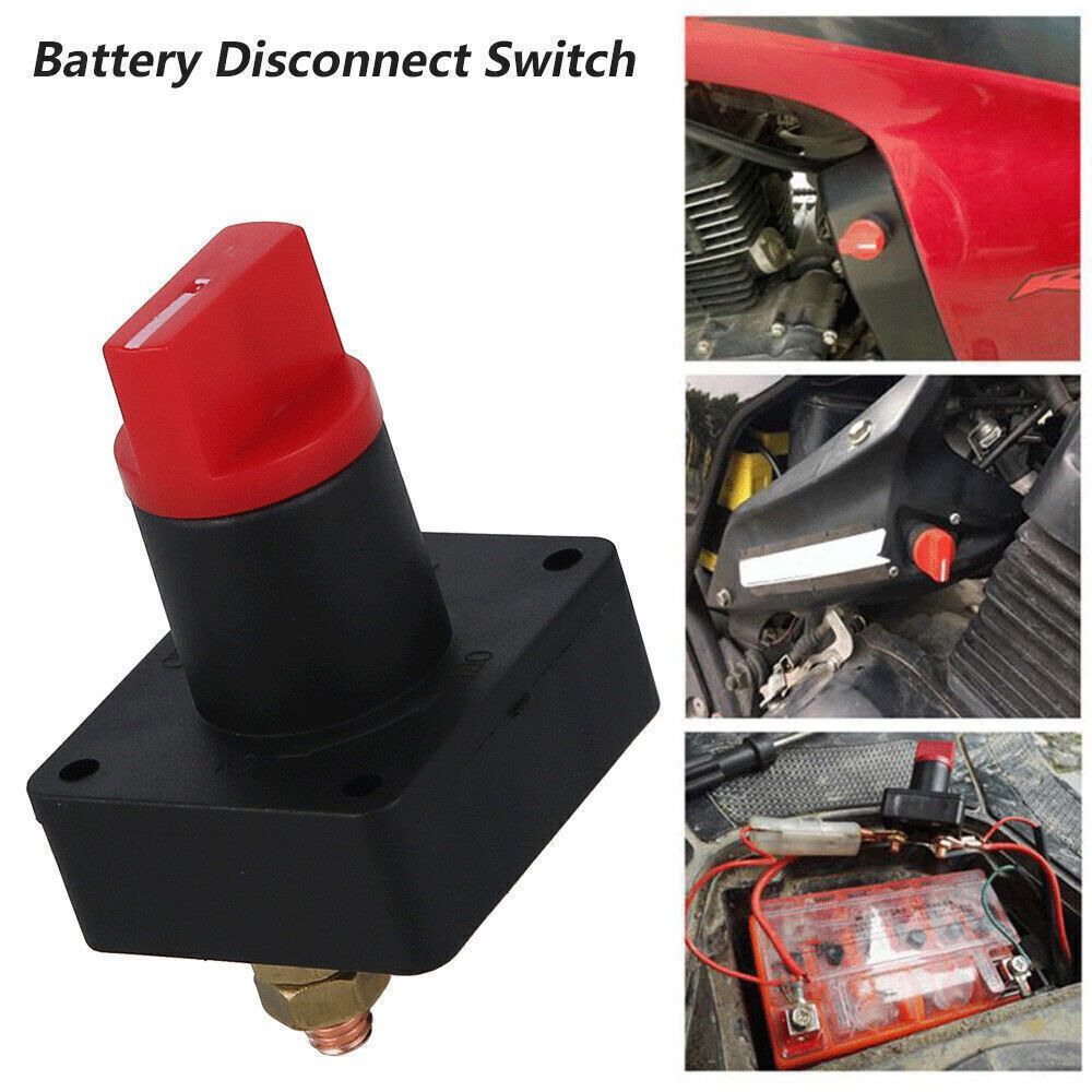

There are battery isolation switches available on Amazon and eBay, they aren't expensive, the one below is available on the UK eBay site for around £10.00. It isn't too large and can be stashed under the seat or anywhere else you can fit it.
