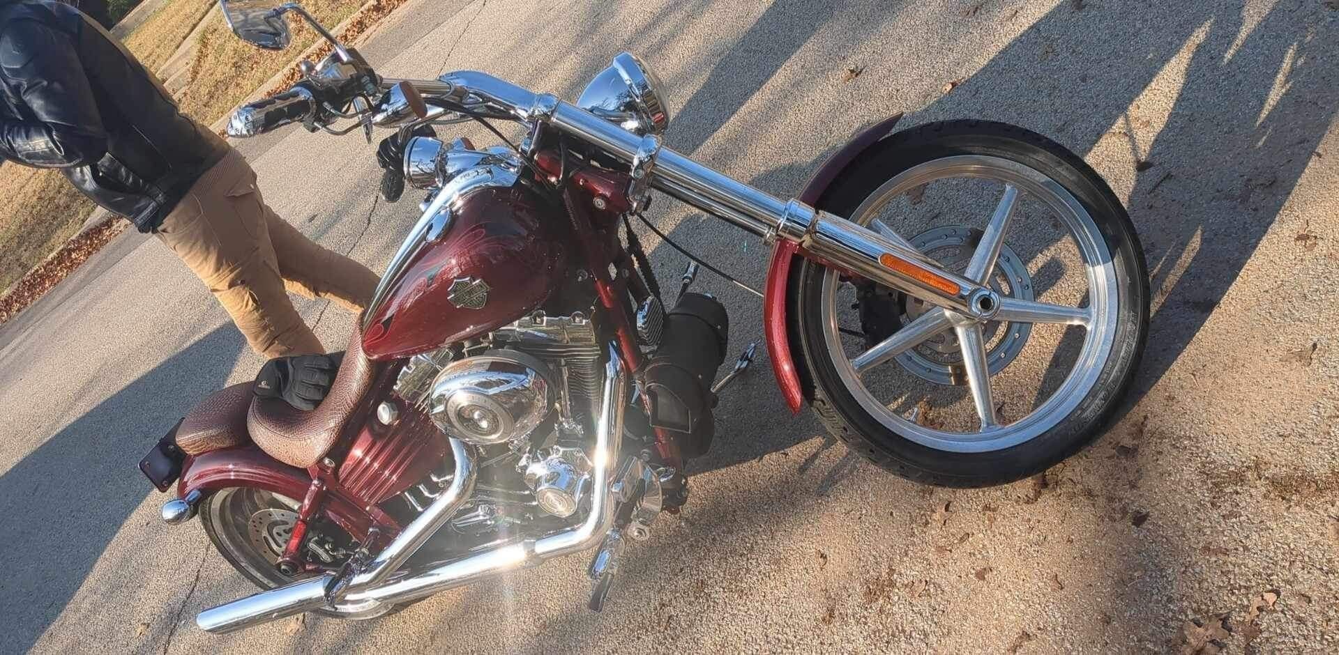

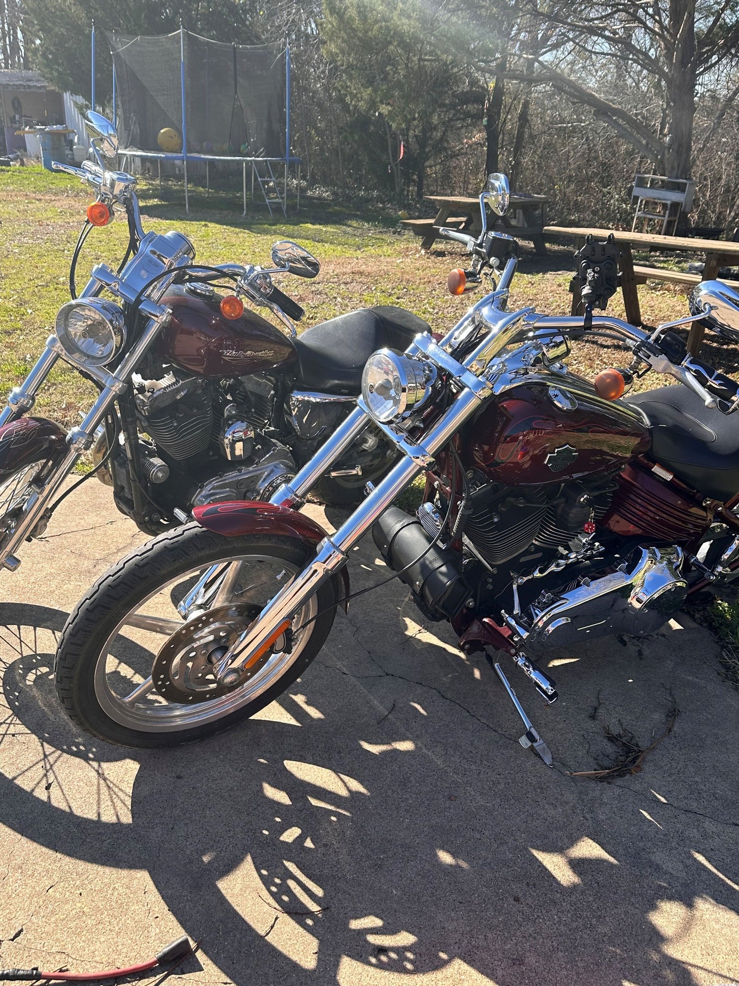

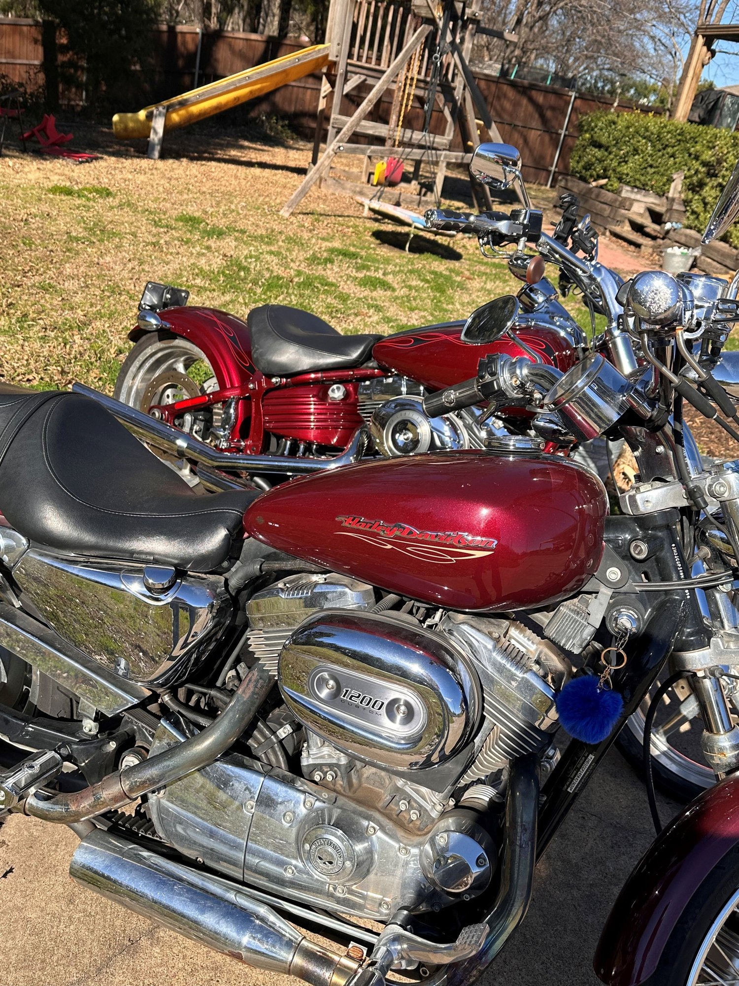

Here are my babies, i bought them both within a month of each other... if i have to have a midlife crisis i'm gonna go all out! The other is a 2009 Rocker C.... I guess i need to take some better pics also lol
