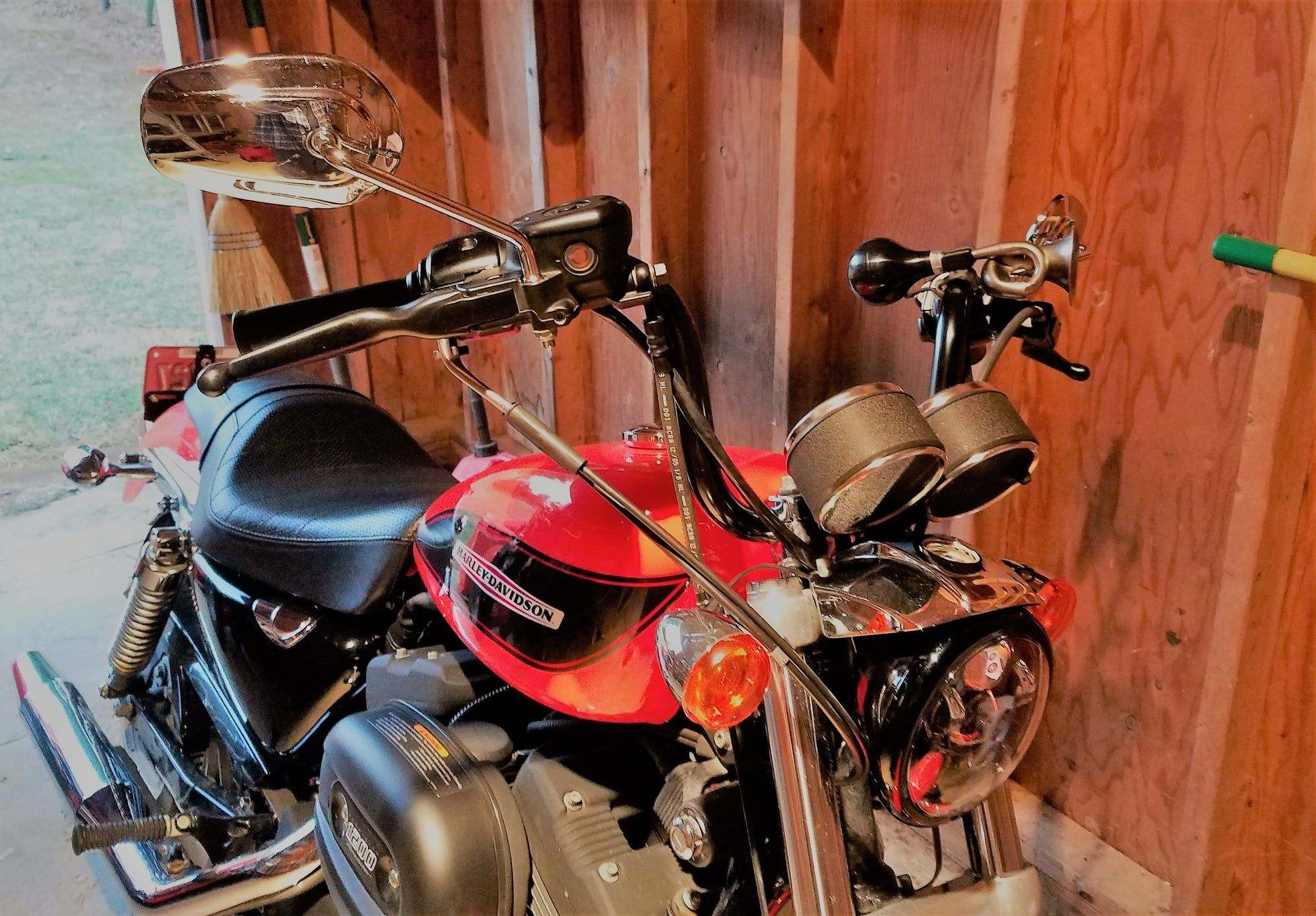

I have an 03 with stock cables. Can I go any higher without replacing cables?
Thanks

Love the horn!

Originally Posted by TwoBlue02
Thanks! I think that answers the question and i will look into getting the bars.
Love the horn!
Thank you for your reply,
I used to have one of those bulb horns on my 1959 BSA C15, it was more suited to a bicycle than a motorcycle, but it was perfectly legal here in the UK.
I sold that BSA to a lady friend in 1984 for Ł60.00.
The Biltwell Chump bars are very good quality, but their price reflects their quality at over $200, if your budget won't stretch to that, there are less expensive options available but make sure the bars you choose have dimples or slotted holes for the switchgear wiring to sit into.
