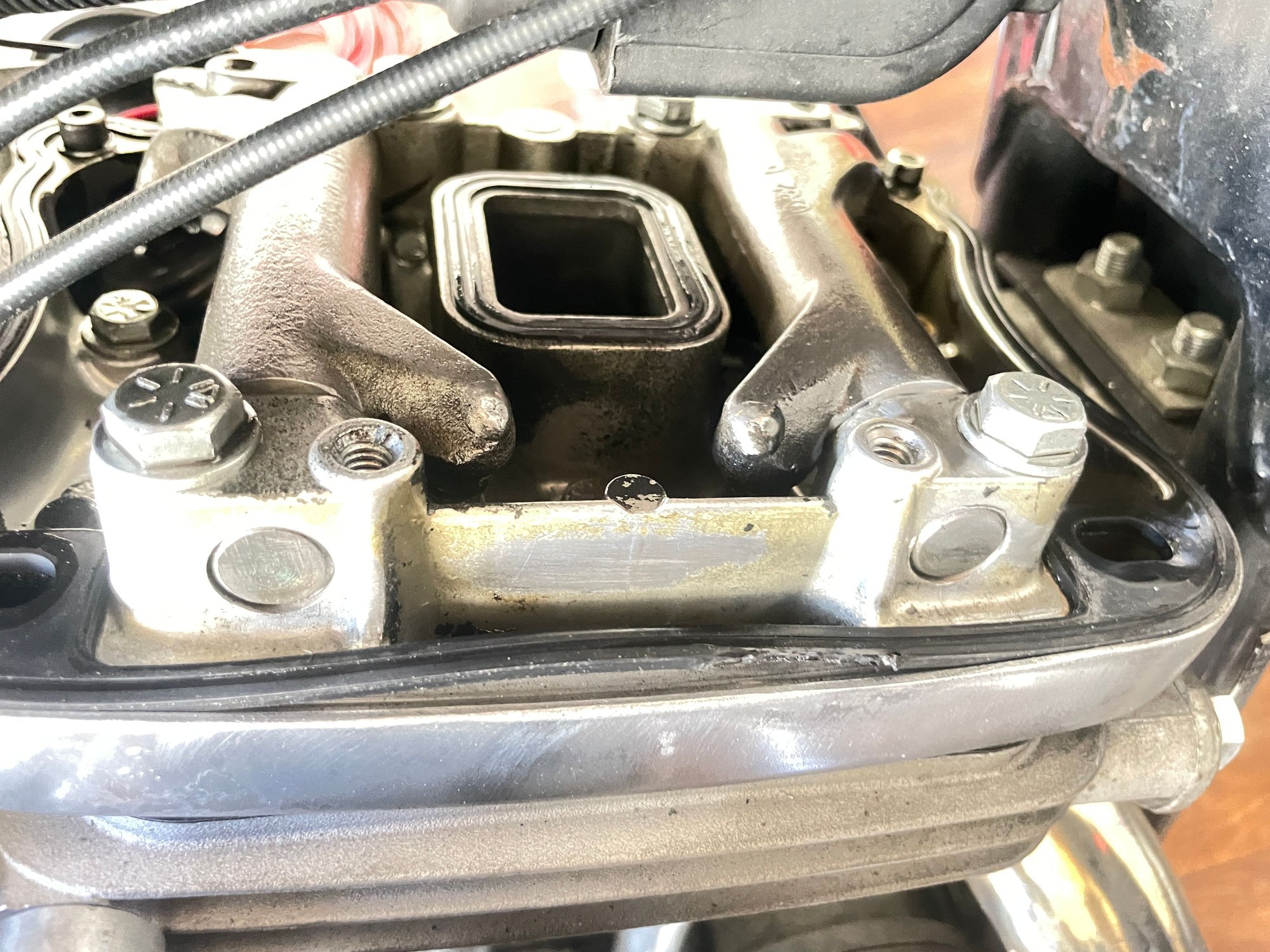

so i had a leak and opened the rocker box to find its mising half the bolts and theres a crack in the bottom rocker box plate so i ordered a new one and am planning to bolt everything right front and back rocker boxes but now im thinking because it wasnt right in the top maybe i have to rebuild the engine to know its done properly. i dont know how to inspect the engine based on it missing bolts other than rebuild it. any ideas on what to do here to avoid a whole tare down and rebuild? 1989 sportster supposedly rebuilt to 1200
the crack i found
missing bolts

I'd fix what's broken/missing and see how it goes after that. Hope for the best, you'll probably be fine.
When you get it all together and it runs, do a compression test, see what the numbers are.
I forget, but I do not recall "Grade 8" hardware for my rocker shaft bolts, so they may have "upgraded" those while forgetting the other two (four?). Who knows WTF was going through the mechanic's mind. Meth?

What bolts are missing? The 4 empty holes in the pic are for the bolts that hold the cover on. The bolts that hold the lower rocker box on all look to be there. The crack also may actually be casting marks, which is what it looks like to me. My rocker boxes were full of them and they do look like cracks.

I also see no cracks. Cast marks are deceiving, even depending on lighting.

its for sure a crack because the other side of the crack has the oil coming through that same spot unless theres some sort of scoring that also looks like burnt oil leaks? im new to mechanics really

theres 4 total holes that the cover uses but are they the ones that go to those 4 holes you can see here? doesnt seem to match up fropm what i think i remember but i bet youre right

Looking at a FSM there is 9 bolts / screws in the inner rocker cover leaving 4 holes to hold the outer rocker cover.
Look at the pattern of the holes in the top outer cover. It has to be obvious if they line up with what you have left. Maybe the screws haven't been placed properly in the inner cover?

Top pic does appear to show a crack, but like these guys said, if its casting marks, they can deceive you.
The bottom pic looks like the gasket is torn or ripped in the front.
