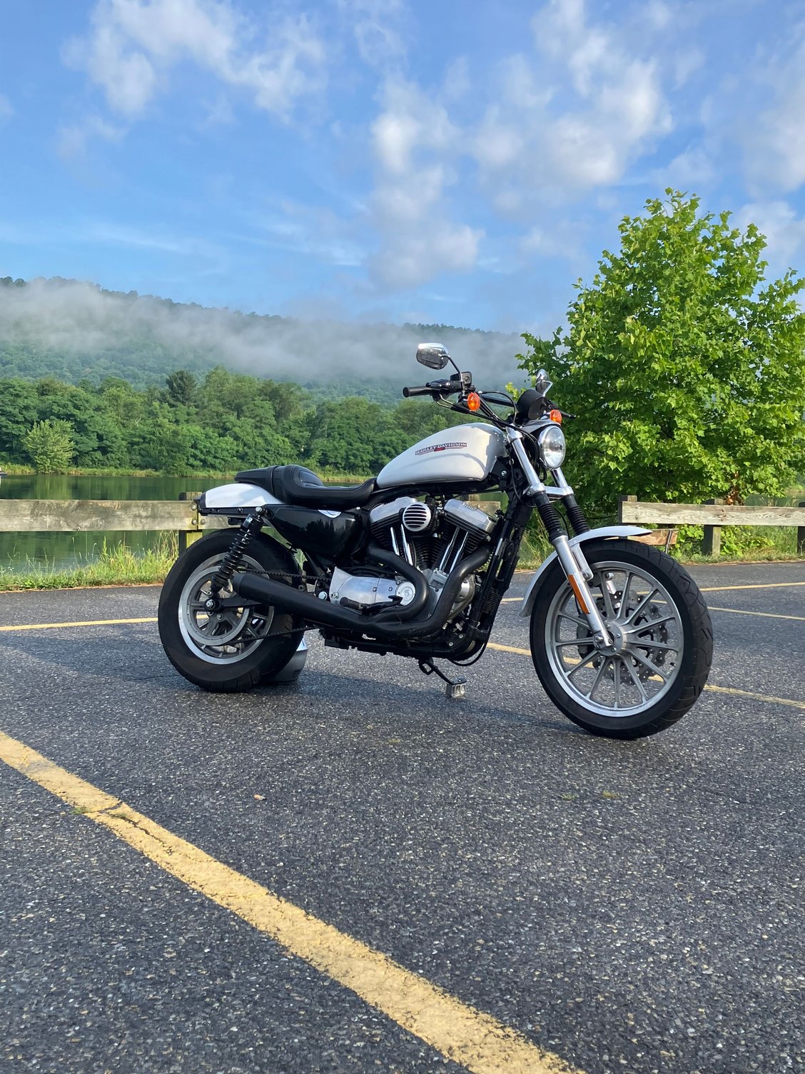

Have a lifted sporty with 7” extended travel kit and 15” shocks. Initially, I had the forks at the top of the trees and the bike rode okay but it was a tippy toppling ride at low speeds. Dropped her three times before making adjustments, funny a lifted sporty is top heavy.
After testing a bit, ended up with the forks up in the trees 23mm. The Traxxion setup rides well too and the 15” progressive shocks aren’t too shabby for cheaper units. The hillbilly sporty is a blast, and if I’m not hitting any interstates +65MPH it’s my favorite ride.
Sounds like a fun experiment, just be prepared to topple around a bit until you find the sweet spot.
